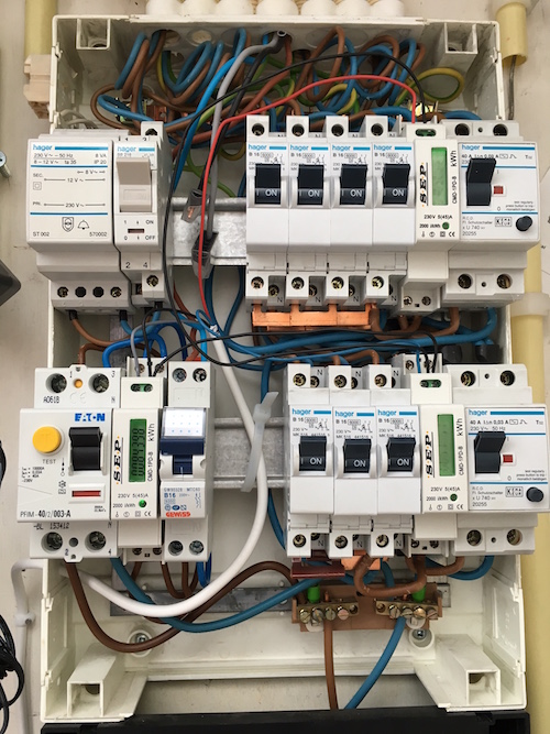

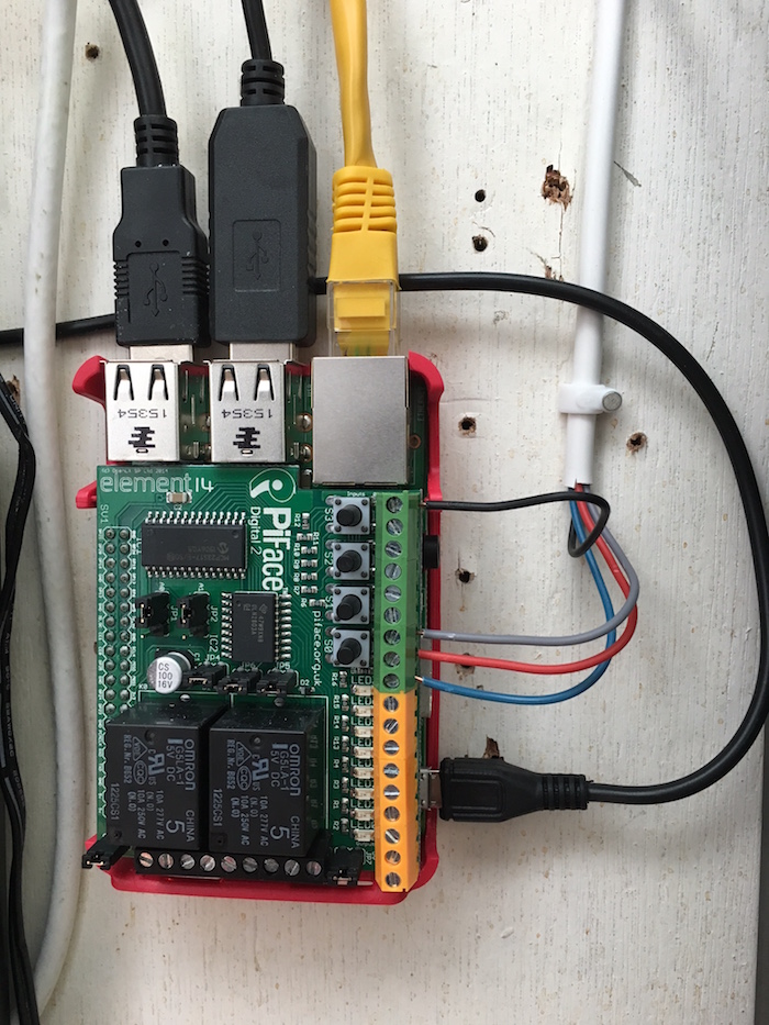

That's certainly possible; I've got pretty much the same setup here. I've got three of those kWh meters with S0 ports. I've made sure these kWh meters generate 2000 pulses per kWh as apposed to 1000 to more accurately measure current power usage. The S0 ports on these kWh meters can be read by additional hardware. I've tried the S0Meter from https://www.domoticz.com/wiki/S0Meter which in my experience is *very* sensitive and produces too high values. I'm currently using a PiFace Digital 2 to read these values, without the added circuits as mentioned in the wiki http://www.domoticz.com/wiki/PiFace and it seems to produce quite accurate values.

- IMG_7209.JPG (184.29 KiB) Viewed 1386 times
- IMG_7208.JPG (290.13 KiB) Viewed 1386 times

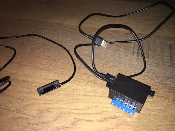

The 5-port S0 pulse counter module from http://www.smartmeterdashboard.nl/webshop currently sells for € 42,-. I've used it to measure my 3 S0 kWh meters as well as my gas-meter using the https://www.flukso.net/content/gas-probe which costs € 12,10. I have no future use for both of them, so you can buy them both for € 25,- ex shipping.
Note that the S0 device is not the PiFace from the picture I posted previously, these are two separate devices. The PiFace mounts directly on the Pi's GPIO pins, the S0 pulse counter uses USB. And finally you mention P1, which is a port/protocol on most smartmeters which you can also use to feed data into Domoticz. You need a cable like this http://www.robbshop.nl/slimme-meter-kabel or you can assemble one yourself.
- IMG_7211.JPG (127.33 KiB) Viewed 1356 times
