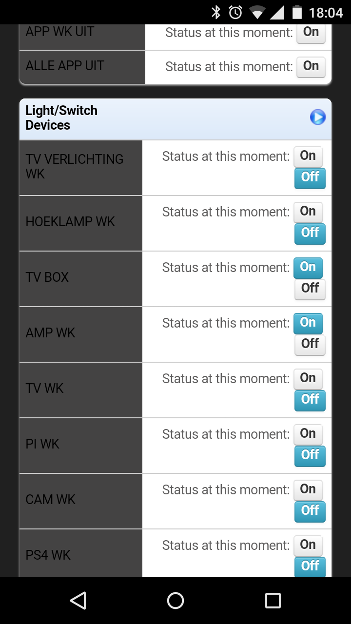

I would want them a bit wider, on my sub 5 inch phone, it is hit and miss. They are displayed below each other:

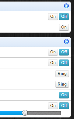

That text "Status at this moment" should not be there...
buttons should be next to each other like this:
Are you using the default domoticz theme/html files ?

I think you are using the element theme... could you change to simple gray for example ?
Will be corrected in a beta
