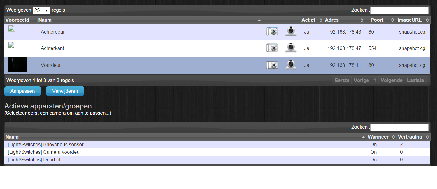

Hi Tom,
I have the following settings. I have made a smart mailbox with a doorsensor.
I've the sensor is triggered Domoticz sends an e-mail with a screenshot. My doorbell works the same way but still have to install it.

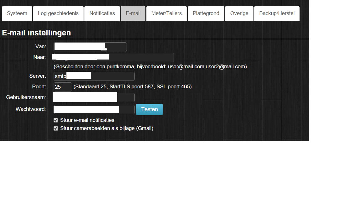

In settings tab e-mail you have to add your settings tick both boxes at the bottom
Since I have my camera above the door i've put a delay on the screenshot. It sends a screenshot 2 seconds later. I usually see the peron who dropped the mail in the screenshot. You can do this here (add the settings to the camera you want to use): Lastly I also made a blockly which sends me a e-mail. Like: But the blockly isn't really necessary. Because you now get 2 mails. One that says mailbox on and the screenshot. I wish I could change the name of this e-mail but have not had time to check this out.

2) I added the Kaku magnetic to both camera's in the camera menu.

I configured email: Stuur camerabeelden als bijlage (Gmail)
Oops: I mostly use Hotmail. It looks like this is a showstopper
But still nothing happens.
- Do I have to configure 'notification' to the Kaku magnetic contact?
- I'm using Hotmail.
Tom
Edit: I have to be a little more patient.
I checked my special mailbox again and I saw that I had lots of mails with camera images as attachment. So it works
