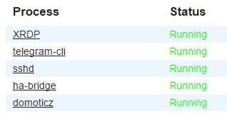

Personally I use monit to monitor my services, so I added ha-bridge using a wrapper file in the config.
Monit Monitoring
Monit Monitoring
https://mmonit.com/wiki/Monit/FAQ
I added the following bash script in the same directory as my jar file, this will allow to start the java file with the correct settings from the data in device.db and habridge.config
Don't forget to make it executable
chmod +x ha-bridge.sh
AFTER saving.
ha-bridge.sh
 #!/bin/bash
 export JAVA_HOME=/usr/local/java/
 case $1 in
    start)
       echo $$ > /var/run/ha-bridge.pid;
##       exec 2>&1 java -cp /home/domoticz/ha-bridge/ha-bridge-2.0.7.jar 1>/var/log/ha-bridge.out
       exec 2>&1 java -jar /home/domoticz/ha-bridge/ha-bridge-2.0.7.jar 1>/var/log/ha-bridge.out
     stop)
       kill `cat /var/run/ha-bridge.pid` ;;
       echo "usage: ha-bridge {start|stop}" ;;
 esac
 exit 0
And added a monit monitoring file in the /etc/monit/conf.d directory
check process ha-bridge with pidfile /var/run/ha-bridge.pid
start = "/bin/bash /home/domoticz/ha-bridge/ha-bridge.sh start"
stop = "/bin/bash /home/domoticz/ha-bridge/ha-bridge.sh stop"
