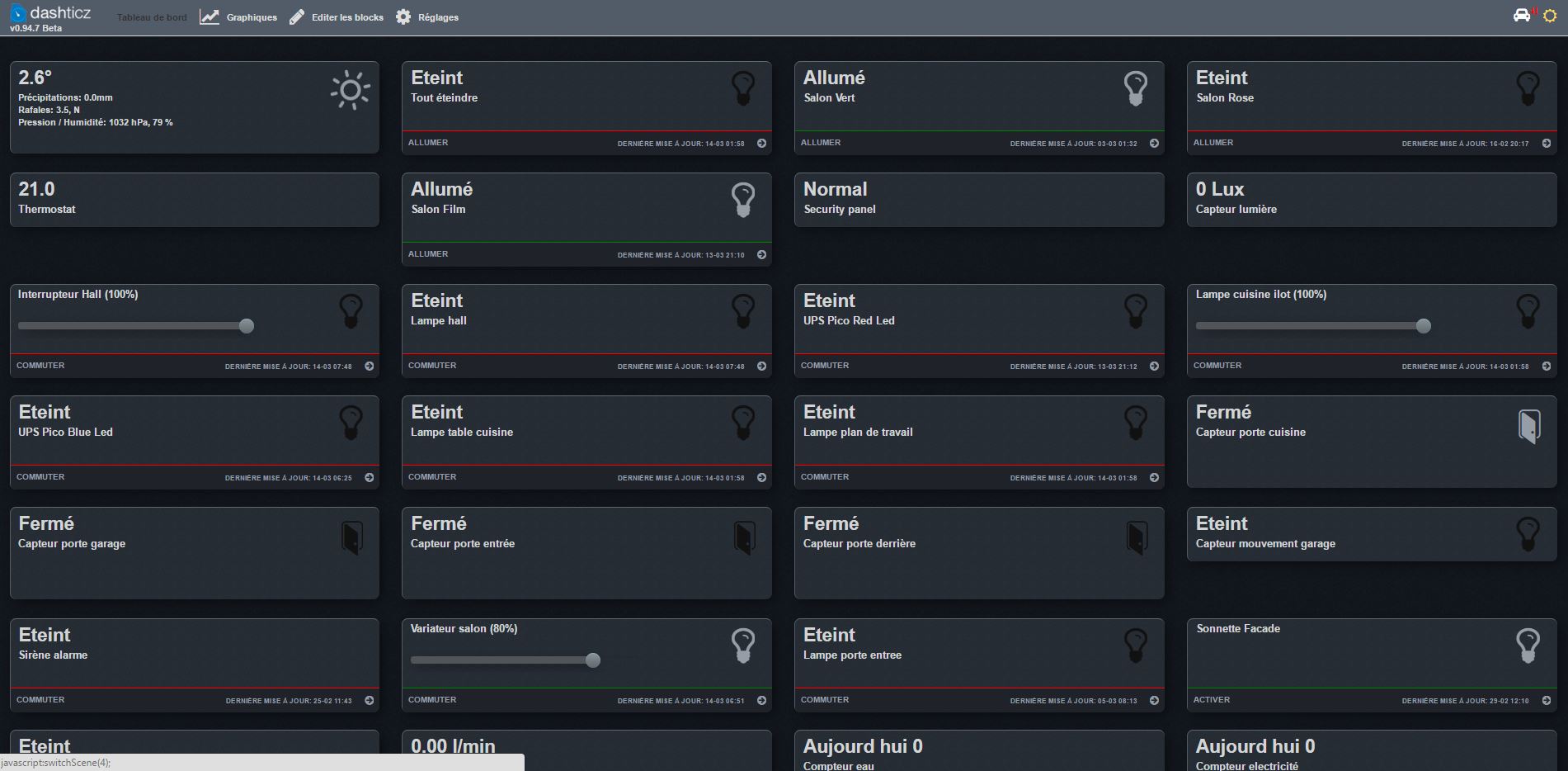

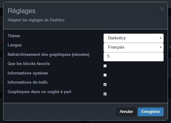

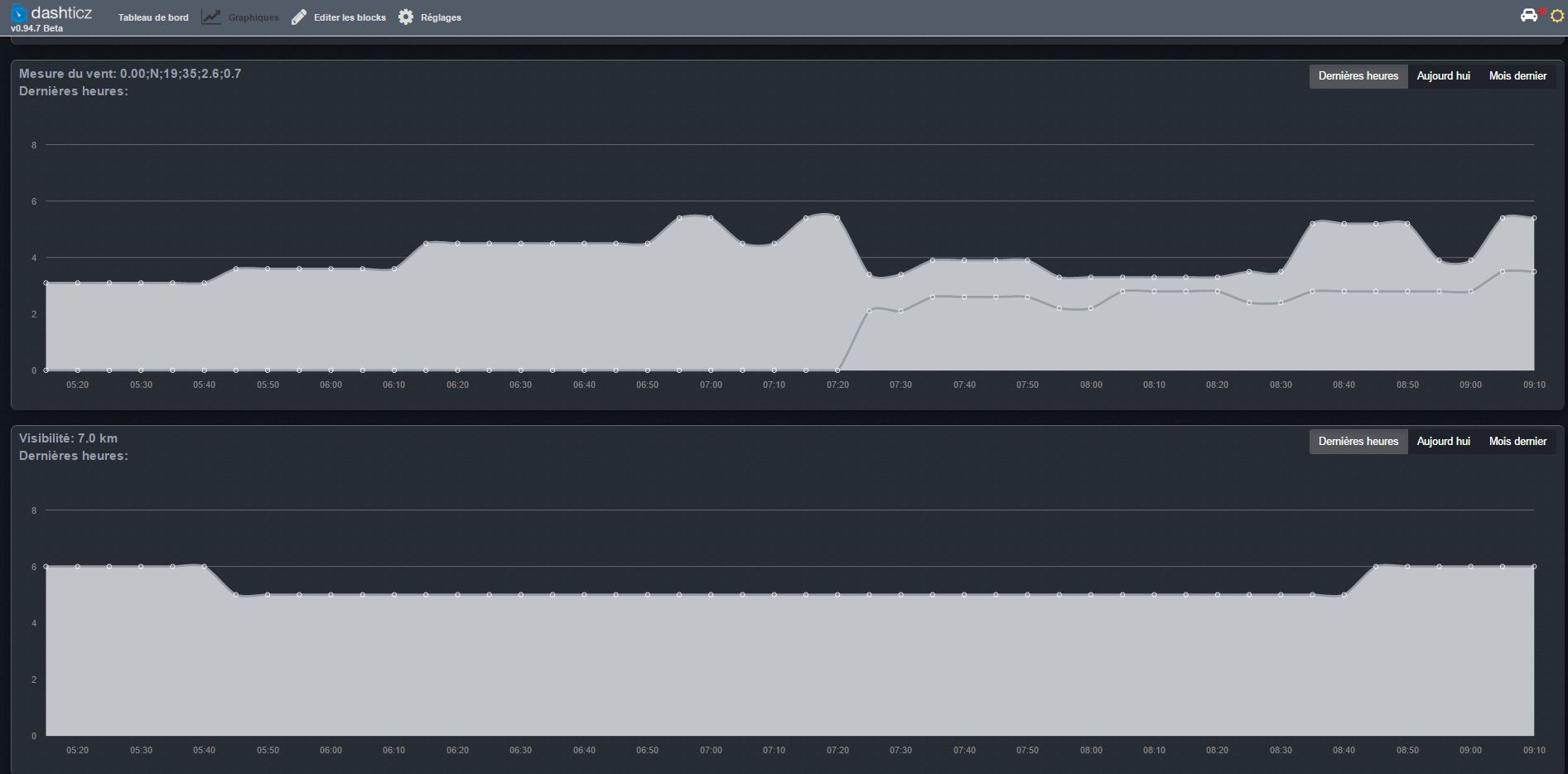

Here attached, pictures of the new wunderground graphs + french translation
