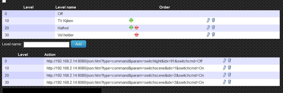

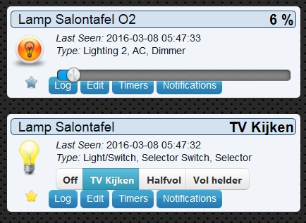

I got a dimmer switch and a selector switch for my Hue lamp.
If I select Off on the selector switch, the dimmer switch changes also to off status.
If I select Off on dimmer switch, the selector switch stays on last chosen and doesn't change to switched off.
I'm using a hardware dimmer switch and if switched to off it set dimmer switch to off. I want auto switch the selector to off too? Than I can hide dimmer switch and only use selector switch.

@arjanw: If I set selector switch as sub device of dimmer switch off button works ok, but when I select one of the other selections after a few seconds off buttons lightens up and selected button isn't lightened up anymore. I tried dimmer switch as sub device of selector switch, but same effect? Looks like there's somewhere a loop?
@wmn79: I tried the script, but same strange behaviour as with sub setting. I can push button from selector switch, but jumps to off button, but off switch is not triggered.
These are the actions for the selector switch...

@wmn79: script works fine. If I push for example Halvol the right command is sent to bulb and executed. Lamp Salontafel O2 is on then. Lamp Salontafel (selector switch) button Halfvol lights up for just a second and then Off button lights up. I expect that the selction I made stays light on, or am I missing something.
