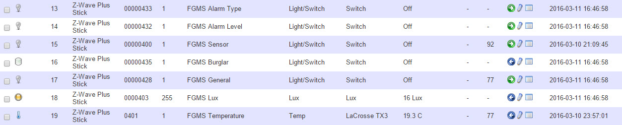

Now I can configure it, but still there are some problems. The temperature is not updated and there is a different between temperature on the temperature page and in the log. The same with the Lux. And sometimes the Fibaro stops working. While there is a movement the LED on the device is not blinking. And also it is reacting slow on movement. The LED is flashing direct when there is a movement, but in Domoticz it takes seconds to react.
Also battery level is showing already 77 while it's working for 1 day now.
See attached devices screen for the data.

I bought 2 of these sensors, but now i need to know what items i can use and what the others are for?
See picture below:
* alarm type
* alarm level
* sensor
* burglar
* general
* lux
* temp
lux and temp is ok, i know what they mean
i was thinking: 'sensor' will go on when it detects motion, but this isn't the case, if you check the 'last seen' values
'alarm type' and 'alarm level' and 'burglar' are going on when detecting motion
anyone can explain me what the other items are for and wich one i need to choose to detect motion?
Thank you!
