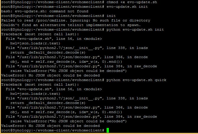

Erwinvos72
- Posts: 61
- Joined: Thursday 25 February 2016 16:30
Re: Domoticz on synology for evohome
Hello Alle,
i did as you told and at this point its busy with
apt-get update: done
apt-get upgrade: done
pip install requests: done
git clone https://github.com/watchforstock/evohome-client.git: done
pip install ./evohome-client: done
But now i like to place the files in the evohome-client directory but i cant find it anywhere.
I quit for today, but as far as i can see the evohome-client is installed, but where i dont know.
I have created the two files but they suggest to place them in the evohome-client directory, so thats a little problem.
next week i will go on with this and hope to also solve this
Thank you for all your help/support etc. So if you have new tips and tricks how to place en reach the files, i will read it and will try it next week.
The Dutch boy
The Dutch boy
- Alle
- Posts: 30
- Joined: Friday 26 December 2014 8:46
- Location: Fryslân boppe, The Netherlands
i forgot a step (cd /home) before you download the evohome-client. The client is now placed in root (cd /evohome-client)
It's better that you move it to /home

i moved the evohome-client directory to /home. But i thought to be smart en copy the 2 config files with winscp, but the debian shell shows other information, so i have to find out how to get those to files in that directory.
Step-by-step i come further
I Found the directory, copied the two files in it
Next step is te make an exe of it, i can do chmod and right away it goes back to the prompt.
Then i do the evo-update.sh init and i receive the error that the file isnt found
So i bit further again, but not still not at the end.

Did you use evo-update.sh or ./evo-update.sh
The last command is correct.

I have tried your suggestions and after moving evohomeclient back to root i could fill in the commands and kind of execute it. But in the attachment you see that i receive an error on json.
Fyi i had to go to the complete path to get the commands working

Okay thnxgordonb3 wrote:Unlike in windows the current path is not where linux tries to find files that can be executed. You need to specify the path to run from in this case:Code: Select all
./evo-update.sh initCode: Select all
~/evohome-client/evohomeclient/evo-update.sh initCode: Select all
/root/evohome-client/evohomeclient/evo-update.sh init
I will try it tomorrow. I saw that the url is mytotalconnect.com. I have no account for that but for mytotalconnectcomfort.com. I tested both but they are different accounts. And i searched for create an account but no luck yet.
First the scripts and then the other stuff

i tried the suggestions but with no luck, it constantly struggles with json. So something is not completely right for my situation
