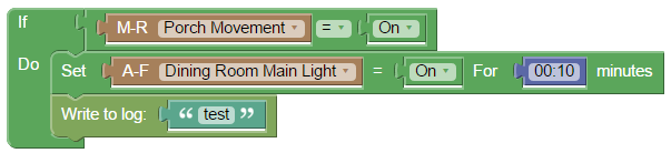

Can someone help me. For some reason, no matter what I do I can't get this to work. Am I doing something wrong?
The test message shows up in the log and if I replace with a set on (excluding the minutes) the this also works. so I know the switches work and the script is being executed.
Very frustrating :x :x :x .
Please help!!

I think you have used the wrong block for the time. It needs the integer block, not a time block.

ahh I see now! doh!!
Ok so that works but it doesn't seem to return to the previous state. Why would that be?

ok so now hat I have set it to turn on for x minutes then it all seems to work :)
