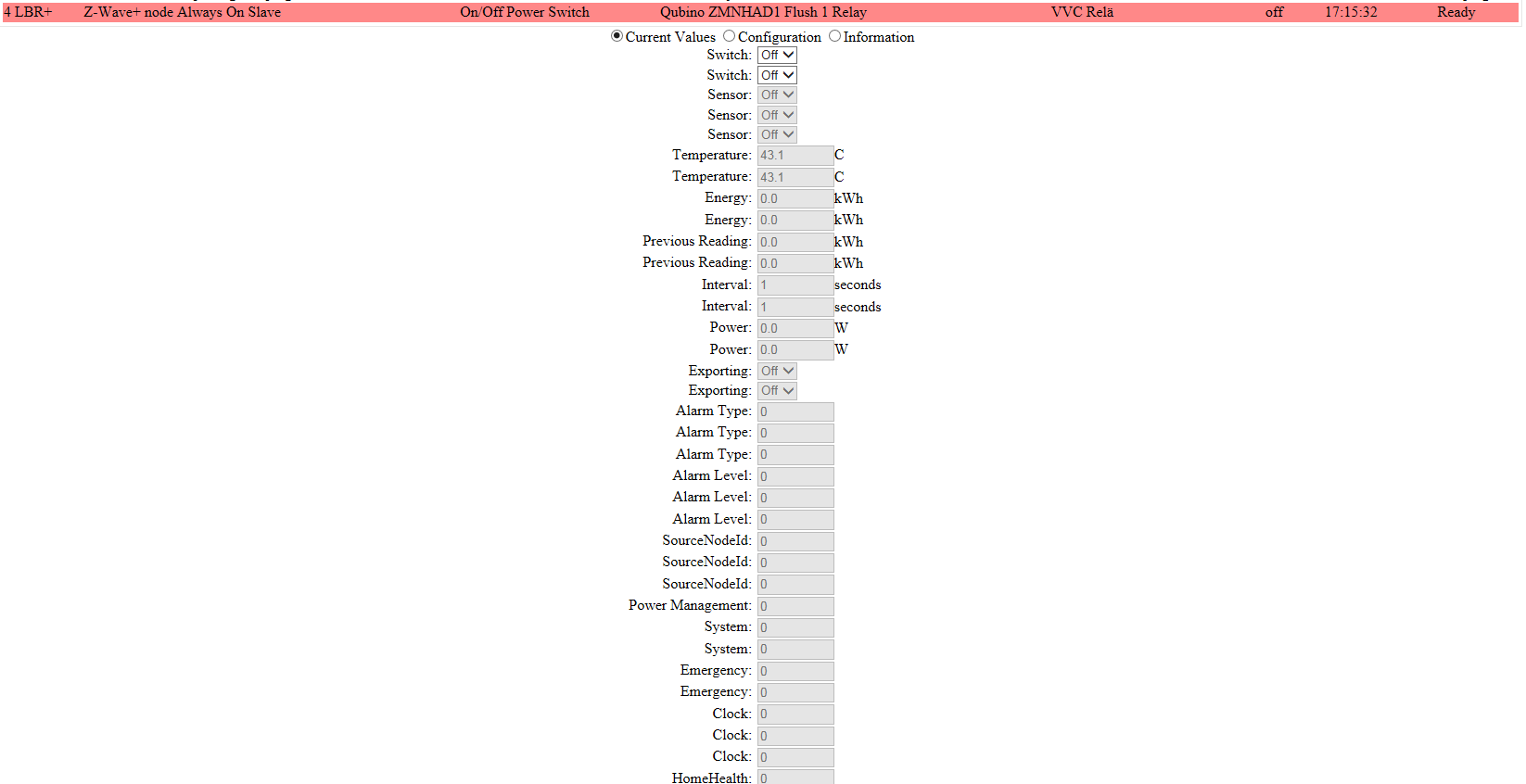

It looks like all the parameters comes several times. And in the OpenZwave control panel it look really strange. I have tried removing the nod and reconnecting it. But it’s coming back all the same. This started after a Domoticz update last week.

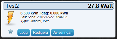

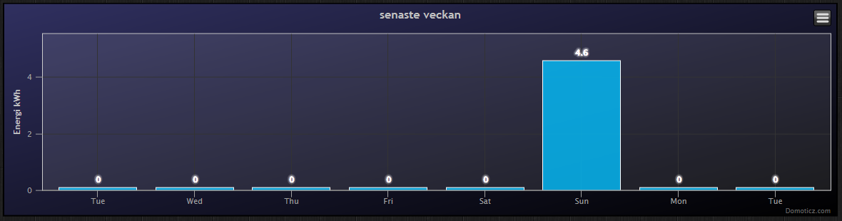

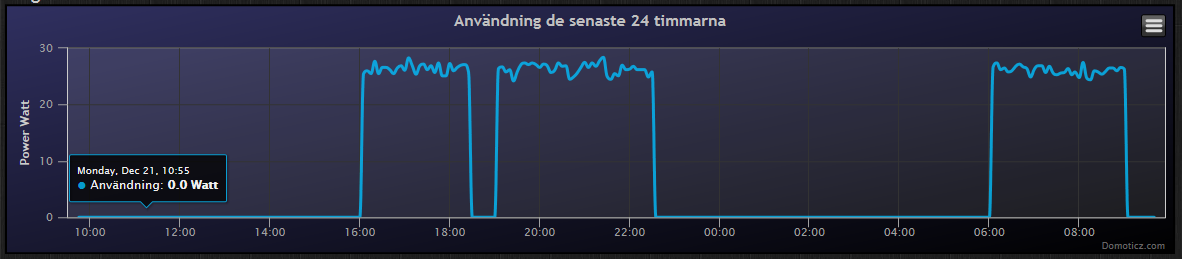

Hey, I wonder how the amount of energy measurement work on these Qubino relays. I get two different meter that reports values. But both reports only instantaneous values, not accumulated. Must it be so? Do I have to solve the accumulated through script or dose this works for everyone else?
This accumulated energy came in when I the same day I updated Domoticz

alveman wrote:Hey, I wonder how the amount of energy measurement work on these Qubino relays. I get two different meter that reports values. But both reports only instantaneous values, not accumulated. Must it be so? Do I have to solve the accumulated through script or dose this works for everyone else?
The accumulated energy stopped working correctly on my Qubino dimmers when the 'general kWh meter' was changed in Domoticz a few months ago.
Before it worked just fine.
