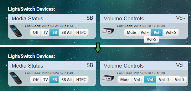

Post by Nautilus »
Was wondering if the area for selector switch buttons could be extended a little bit (with some sort of css magic perhaps :))? I think e.g. these volume buttons should fit to the area without line break but at the moment it does not:
I can of course change the texts to a bit shorter or use drop-down style, but extending the "selector options" area would be the preferred option - if it is doable :)

Post by nayr »
i'll do some more work cleaning up selector switches soon, but @Nautilus I think i have that as wide as I could get it without breaking it for other devices.. I'll revisit though since I am going to need to refactor that device, mebe you'll get lucky :)
