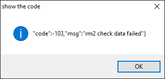

I've received my RM2 pro a couple of days ago and I'm trying to make it work with domotic.
RM bridge is running on my Android tablet, curl and RM commander installed on my pc.
I've set my_tablet_ip:7474 on "identification on the network" but when I try to learn a code I get this error for every button I've tried with my IR remote :
I also tried the website http://rm-bridge.fun2code.de, set the ip running rm_bridge but it do not work, it shows Error learning code: rm2 enter study mode failed any time I try to learn a code.
I had no problem at all to learn a couple of remotes (IR and RF) with the Broadlink's app.
Do you have any idea ?

I have also received RM2 last week. And also I have the same error. it may be for the firmware version. I have updated to version 20022
getafe83
Joined: Friday 04 March 2016 14:04
Re: Using BROADLINK RM2 on DOMOTICZ
Post by getafe83 »
Would anyone who has upgraded to version 20022 and it works?

edit: Found it, it's actually using version v20020 and I can upgrade to v20022 which has been published 2016-01-29.

I have also received RM2 with 20020 version. But the version I have updated because it showed the incorrect temperature and updating has been fixed. if you have the same error with version 20020, maybe it is not firmware problem. I need to try rmbridge version 1.0.0 and rm commander

I'm in touch with the dev from RM-Commander and the one from RM-Bridge, it seems there is a new version version of the RM with changes in the API and that's why those softwares don't work anymore.
I've given them control of my RM through internet so they can update the softwares.
getafe83
Post by getafe83 »
I tried it with rmbridge version 1.0.0 and rm commander unsuccessfully.
As Zycker says; it seems there is a new version version of the RM with changes in the API.
When you know something let us know. Thank you
