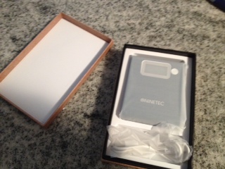

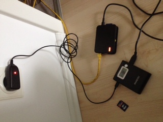

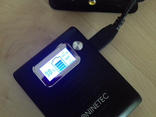

Now my Power-Bank has arrived for just 19,99€.
- 10Ah
- LCD Display with Power-Level
- 1 input connector = Mini-USB, fitting to any Raspi power-supply
- 1 output connector USB-A 1A
- 1 output connector USB-A 2.1A
