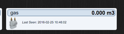

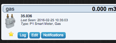

I'm created a dummy hardware with a device. I can see that the data is displayed as data in the list.
In utility the data is displayed only in small characters in the second line and in my dashboard not at all.
I've tried a lot of differed hardware settings, P1 Smart Meter, RFX Meter, General, etc, but without results and I'm looking for suggestions

I have done the same. I update the gas (and electricity) values with a separate daemon. I already made an interface to collect the P1 values and store that in an Access database. I want to keep that for now, hence i did not use P1 hardware interface in Domoticz.
Where it shows 35.036 for you, it shows my gasmeter value and where it shows 0.000m3 for you it will show the delta to the previous reading (calculated in Domoticz).
You may have a brand new gasmeter, but your value looks low to me. My value is 2200.863. Are you sending your gasmeter values as a float ?
I have attached the daemon (written in Python) and documentation as it might help you. The deamon takes input from a file and has flexible configuration options for the information to parse (often needed to capture the gas information).
