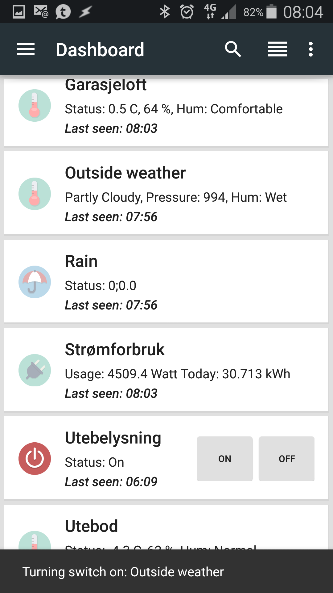

In the Dashboard I have my favorites, where I have a group called "Utebelysning". When I press its buttons, I get the notification underneath saying "Turning switch on: Outside weather".
Well, outside weather is not a switch - it's a thermometer.... :) Utebelysning should turn on my outdoor lights, but it doesnt.
However, if I go into Scenes and turn on Utebelysning from there, it works.
