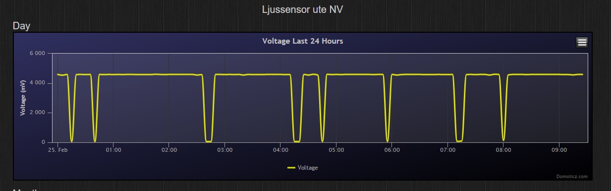

Domoticz was not working when I called from bash. It showed wrong values.
This is how the log of the sensor looks. The low values are the correct ones. As you can see it doesnt looks normal :)
ljussensor logg.jpg (78.12 KiB) Viewed 12377 times
When looking in the domoticz log it looks like this:

It is the one called "Ljussensor ute NV" that I doesn't work.
LazyLizzard
