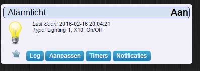

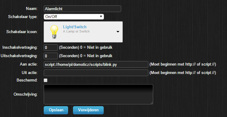

I got it so far the blink.py script runs when I SSH sudo python blink.py. So the script works, but now I try to copy i to a switch:
I did:
In the virtual switch set the on command to script:///home/pi/domoticz/scripts/blink.py
nothing happens when I press the device on.
changed the command to: script://home/pi/domoticz/scripts/blink.py (one / less)
still nothing happens
What am I doing wrong?
I did:

Re: Blink device script
This has been answered many times on the forum.
chmod +x /home/pi/domoticz/scripts/blink.py
Aan actie:
Aan actie:
Sorry, this is my first script.
I got the script running, but in the log I see:
Error: Error executing script command (/home/pi/domoticz/scripts/blink.py). returned: 512
Through SSH the scripts is running, so my conclusion is that the script is allright.
It likely needs 3 slashes (/) not 2 after script:.
Create file "blink.sh" with content:
#!/bin/bash
/home/pi/domoticz/scripts/blink.py&
chmod +x blink.sh
Aan actie:
script:///home/pi/domoticz/scripts/blink.sh
This works for me
#!/bin/bash
chmod +x blink.sh
Aan actie:
This works for me
The script has Windows newlines, not Unix style.
The last line needs to be terminated.
Perhaps remove indentation of first line.
See -
viewtopic.php?t=5315
Unfortunately my TKB TZ68 switch, or my Zwave network, doesn't respond quickly enough to create regular flashes.
It also fills the log up!
See -
@Sweetpants: Did what you said, nothing happens. Run the blink.sh script in Putty gives:
blink.sh is:
Again: running /home/pi/domoticz/scripts/blink.py straight in putty gives flashing light, zo blink.py works, only to get it run in Domoticz seems to be the problem.
pi@raspberrypi ~/domoticz/scripts $ /home/pi/domoticz/scripts/blink.py: line 2: import: command not found
/home/pi/domoticz/scripts/blink.py: line 3: import: command not found
/home/pi/domoticz/scripts/blink.py: line 4: import: command not found
/home/pi/domoticz/scripts/blink.py: line 5: import: command not found
/home/pi/domoticz/scripts/blink.py: line 6: import: command not found
/home/pi/domoticz/scripts/blink.py: line 7: import: command not found
/home/pi/domoticz/scripts/blink.py: line 8: import: command not found
/home/pi/domoticz/scripts/blink.py: line 10: syntax error near unexpected token `('
/home/pi/domoticz/scripts/blink.py: line 10: `def open_port():'
#!/bin/bash
/home/pi/domoticz/scripts/blink.py&Master: RPI Model 2B
I changed some things in notepath and now I got it running even in Domoticz. Thanx for the help, something with open en save in notepath did the trick...
