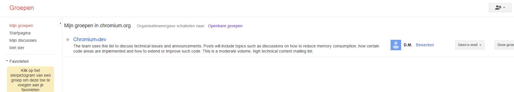

To obtain an API key, join the Chromium Dev group and create a project through the Google Developers console.
Then select your project. In the sidebar, navigate to “APIs & Auth.” and activate the Speech API. Under “APIs & Auth,” navigate to “Credentials.” Create a new key for public API access.

i did join the group...
only no key..
just a lot of mail from the forum.. [ can i turn that off? ]

This is just to get the api key. If you joined the Devgroup you shoud be able to find the Speech API, enable it and then under credentials create an API key.

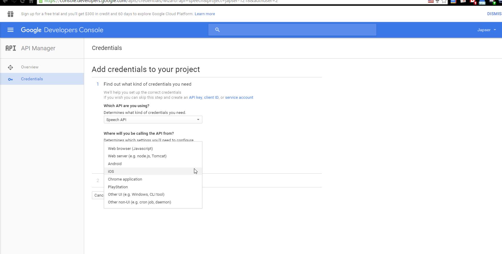

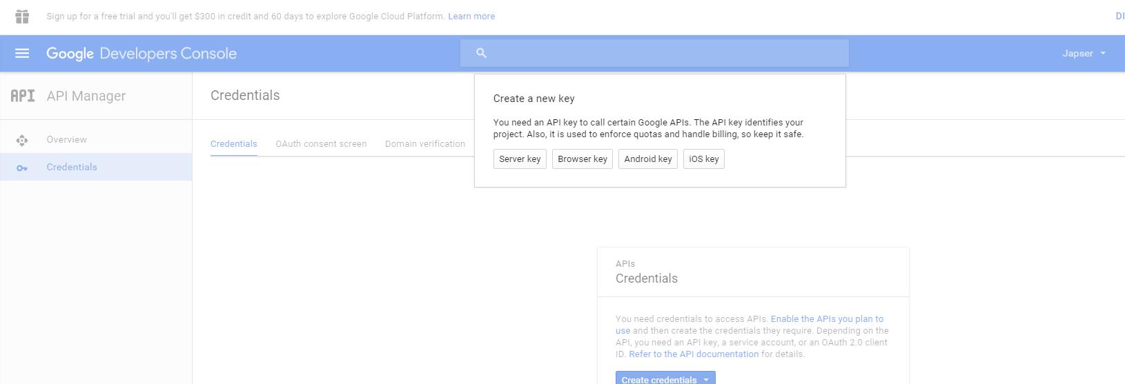

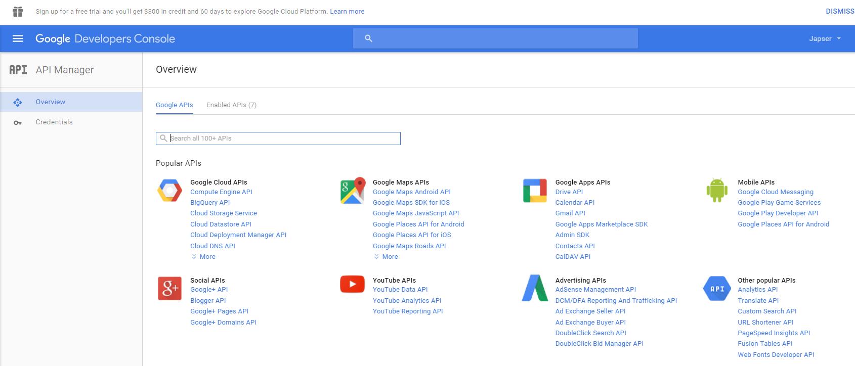

almost i think..
Hard to get, for a dombo...
I can choose a lot..:
only not the one you says...
Found one only what sould i do now:
so what is my next step....
nlooije
Posts: 18
Joined: Wednesday 10 February 2016 14:14
Re: Domoticz voice recognition with Jasper
Post by nlooije »

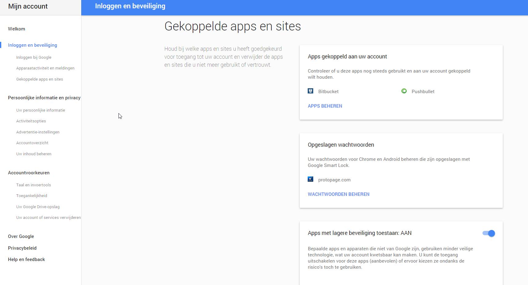

Are you absolutely sure you are part of the devgroup? follow this just to be sure...
make sure also that the account you used to sign up for the devgroup is the same account for the dev console.
if all works you should be able to enable the speech api and create the api key.
If it still doesn't work, consider installing another STT engine

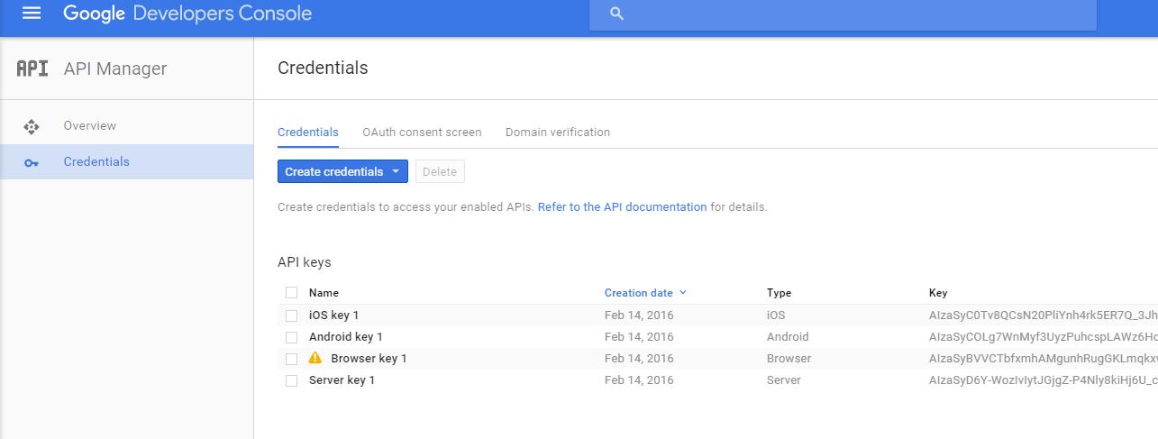

I think i got something:
And this is it gues?
nlooije
Posts: 18
Post by nlooije »
Yeah so Server key 1 is the Speech API key, enter that into profile.yml

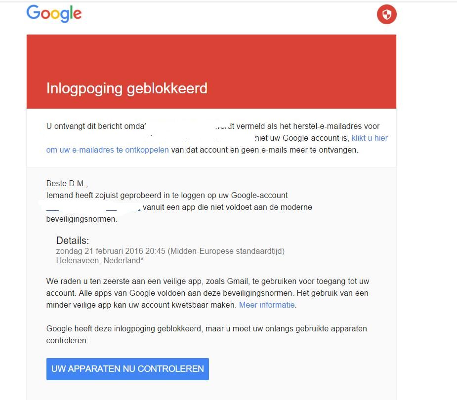

aspberrypi 4.1.13+ #826 PREEMPT Fri Nov 13 20:13:22 GMT 2015 armv6l
The programs included with the Debian GNU/Linux system are free software;
the exact distribution terms for each program are described in the
individual files in /usr/share/doc/*/copyright.
Debian GNU/Linux comes with ABSOLUTELY NO WARRANTY, to the extent
permitted by applicable law.
Last login: Sun Feb 21 19:40:24 2016 from 192.168.5.5
pi@raspberrypi ~ $ /home/pi/jasper/jasper.py
*             JASPER - THE TALKING COMPUTER           *
* (c) 2015 Shubhro Saha, Charlie Marsh & Jan Holthuis *
WARNING:root:tts_engine not specified in profile, defaulting to 'espeak-tts'
ALSA lib pcm_dmix.c:1018:(snd_pcm_dmix_open) unable to open slave
ALSA lib pcm.c:2217:(snd_pcm_open_noupdate) Unknown PCM cards.pcm.rear
ALSA lib pcm.c:2217:(snd_pcm_open_noupdate) Unknown PCM cards.pcm.center_lfe
ALSA lib pcm.c:2217:(snd_pcm_open_noupdate) Unknown PCM cards.pcm.side
ALSA lib pcm.c:2217:(snd_pcm_open_noupdate) Unknown PCM cards.pcm.hdmi
ALSA lib pcm.c:2217:(snd_pcm_open_noupdate) Unknown PCM cards.pcm.modem
ALSA lib pcm.c:2217:(snd_pcm_open_noupdate) Unknown PCM cards.pcm.phoneline
ALSA lib pcm_dmix.c:957:(snd_pcm_dmix_open) The dmix plugin supports only playback stream
No disturbance detected
WARNING:client.stt:Empty response: Nothing has been transcribed.
ERROR:apscheduler.executors.default:Job "Notifier.gather (trigger: interval[0:00:30], next run at: 2016-02-21 19:48:36 UTC)" raised an exception
  File "/usr/local/lib/python2.7/dist-packages/apscheduler/executors/base.py", line 108, in run_job
    retval = job.func(*job.args, **job.kwargs)
  File "/home/pi/jasper/client/notifier.py", line 39, in gather
    [client.run() for client in self.notifiers]
  File "/home/pi/jasper/client/notifier.py", line 18, in run
    self.timestamp = self.gather(self.timestamp)
  File "/home/pi/jasper/client/notifier.py", line 43, in handleEmailNotifications
    emails = Gmail.fetchUnreadEmails(self.profile, since=lastDate)
  File "/home/pi/jasper/client/modules/Gmail.py", line 63, in fetchUnreadEmails
    conn.login(profile['gmail_address'], profile['gmail_password'])
  File "/usr/lib/python2.7/imaplib.py", line 507, in login
    raise self.error(dat[-1])
error: [ALERT] Please log in via your web browser: https://support.google.com/mail/accounts/answer/78754 (Failure)

Look Jasper is running.
Looks the mic is working
The headphone is working one time, by the boot..
Where do i go wrong...
Is there a way that i can monitor my putty without a extra start of Jasper.
Edit:
Other problem.... A gmail block. :-(
Edit:
Fixed the Mail error..: ;) :D :D
Edit:
Edit:
