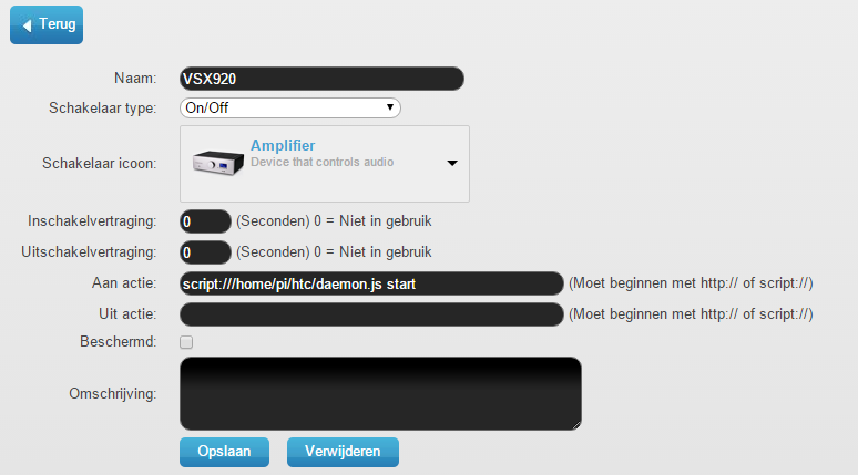

Somehow the cronjob fails?! Don't know why did try every possible situation. First think i saw, i forgot was /pi/ 8-)
But for now the vsx ping switch starts the daemon back on when not in use.
