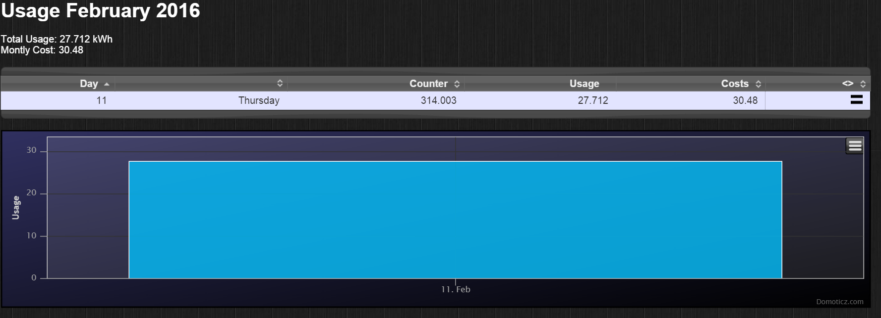

This is correct:

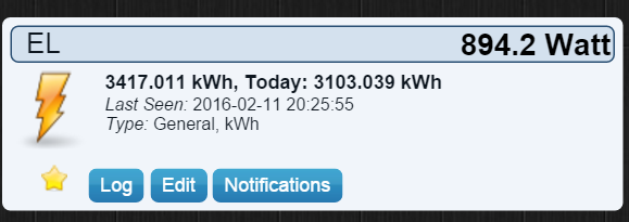

This is not (same device), wattage is correct:
Why the big difference in kWh? I have never used 3412kWh with this new counter. 341,2 is more true.
I understand the big difference from 0 to where the counter is today but it does not change. The "Today:" part in the last picture will show the same high values tomorrow. I have removed and re-added the same device several times trying to figure out how it works.

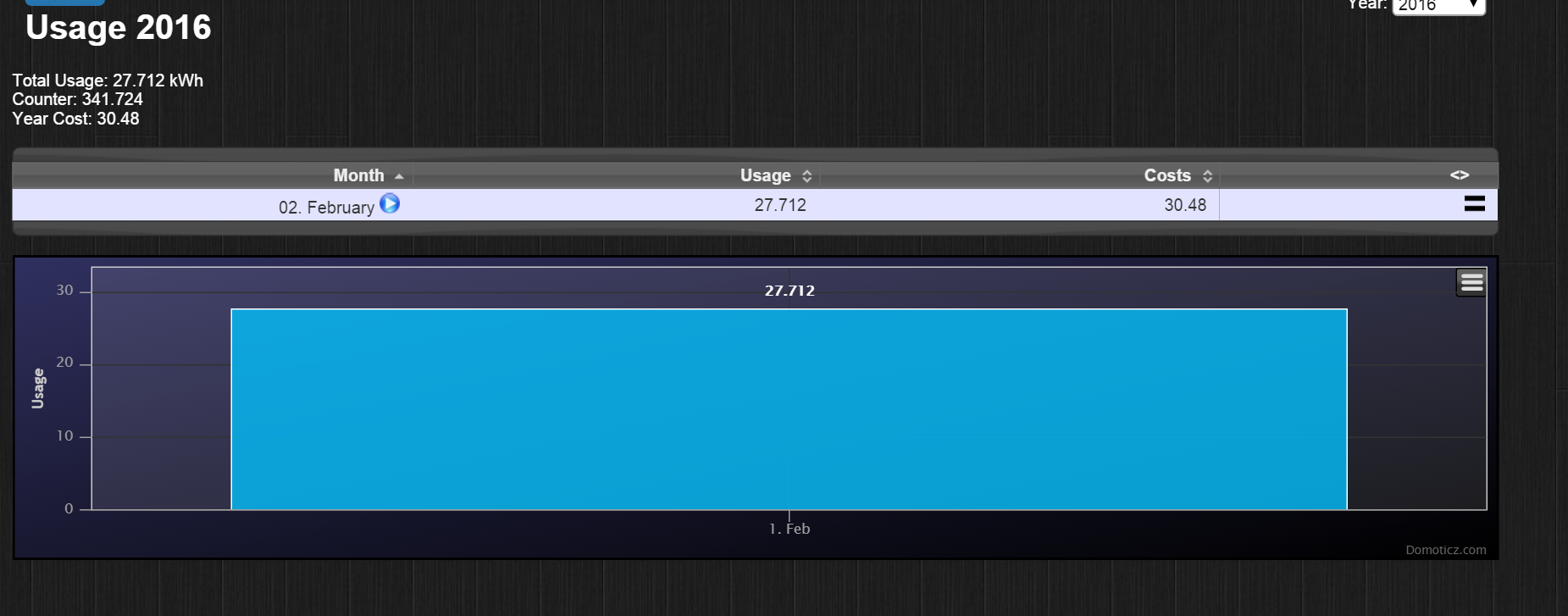

Edit:
If I divide currval with 10 i should get Wh. When doing that it becomes the other way around. The last picture will show the right numbers but the usage per day becomes way lower then actual usage.... I can however add another device that the first information is correct and the second one incorrect and one the other way around.. seems lik a bad solution..
