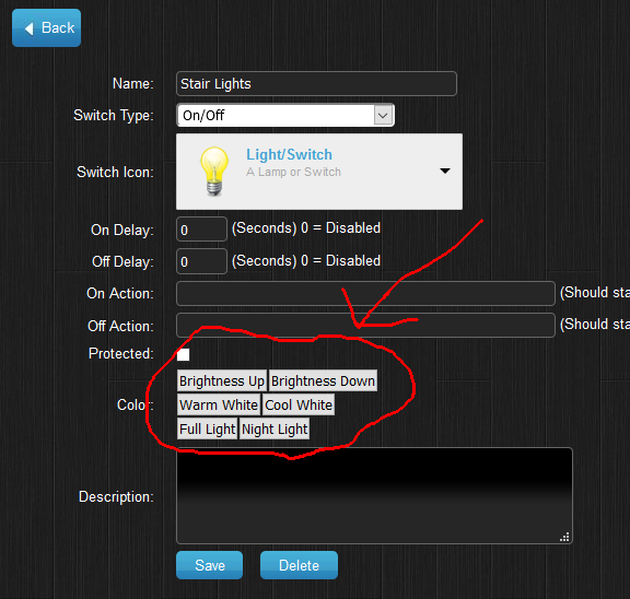

I have a bunch of milight/limitless/applanp white bulbs, and so far all I can do is turn them on and off from a scene.
They have buttons in the colour section for brightness etc. but there seems to be no way to make a scene that triggers one of these, and I can't do it in blockly either.
I'd like to avoid doing it with a bash script as then Domoticz becomes unaware of the state of the bulb.
Any ideas?
