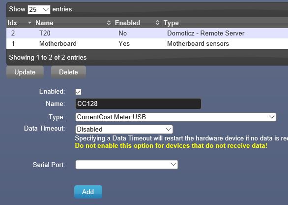

Just go to Setup/Hardware and add a new device without forgetting to specify the Serial port.
Add_CurrentCost
Add_CurrentCost
