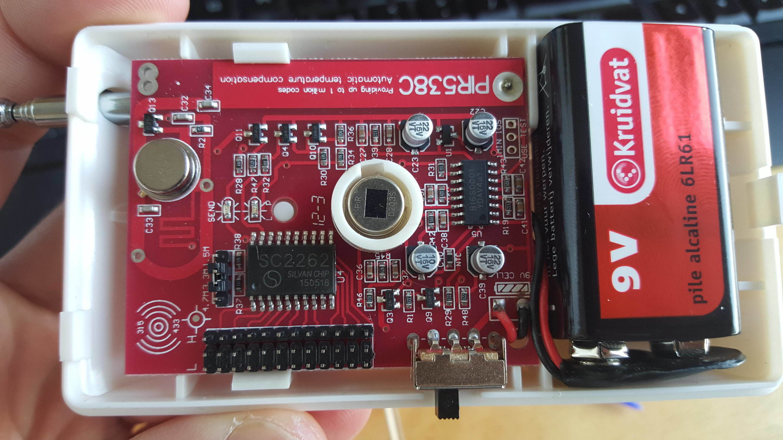

I am pretty new to Domoticz.
Lets start with my hardware:
- Raspberry 2 running Domoticz
- RFLink Gateway
I got some more lamps and stuff, but not really relevant to my question.
Couple days ago i received my PIR motion sensors from China. They are 433 and got the right chip.
I searched the internet, but I can not find a manual how to connect my jumpers... One I did on the 3.3 as adviced everywhere.
At this moment my RFLink sees the motion sensor, but no input or whatsoever. I think the problems are with my jumpers.
I've added a photo.
Please help :D

Re: Question: How to set jumpers on Chinese PIR Motion serns
Post by peerkersezuuker »
I have one to, and i set the jumpers as mentioned here : viewtopic.php?f=17&t=2179&start=180#p51236
Ans it shows up as a Light/Switch EV1527, and is working fine.
