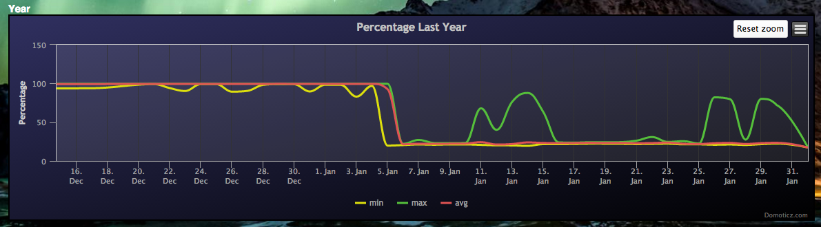

I wish it would have been working for me. But it's not just about the awful reliability. My CPU use skyrocketed on Oct 14th 2015, and went back down yesterday when I switched from MQTT to the REST API. I think it was because of a Domoticz change, as I've been running the same MQTT scripts since last summer.

thats pretty dramatic, was that your script eating up cpu or domoticz?
ive seen no increase in cpu load since using the MQTT interface, quite the opposite actually.. my memory usage was pegged @ 100% and settled down once I started moving old scripts over to it.. but I also started cleaning up things and using a common library.. removed a ton of event scripts since I dont have to make calls to my software.
It just goes to show, it all comes down to your code.. its going to be hard to peg this on MQTT specifically, yeah the URL API is able to cope better.. that could be for lots of reasons.. MQTT is definitely a more raw interface, and less forgiving than the URL API.

I still sent the same data to Domoticz, and Domoticz still listens to domoticz/in. There's just no traffic in there.
So all I did was to change the publishing of my sensor values from mqtt to the rest api. I use a perl script, and the change was literally a one-liner, from mqtt publish to http get. So all the same functionality is still there, only the publishing method changed.
