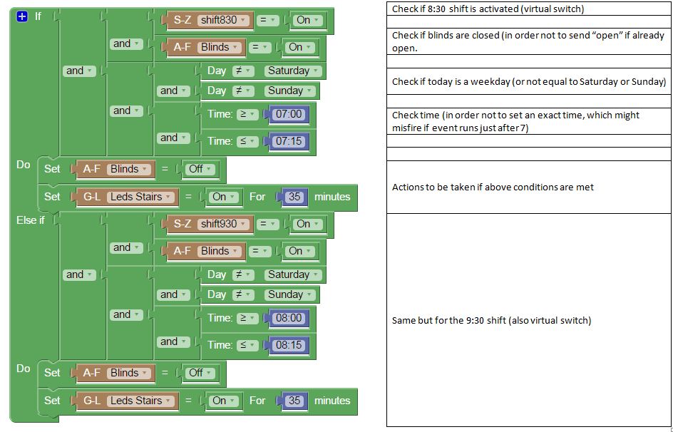

I have created to virtual switches for to different shifts at work. Depending on the fact that either one of them or none (holidays or other exceptions) is set to On execute some actions at the time specified according to the shift.
Yesterday I activated the 830 button and closed the blinds. But this morning nothing happened (blind nor lights) as if the conditions were not met.
Any ideas why?
Blockly: timed (and conditioned) event not triggered

How did you close your blinds? Did you do it from Domoticz itself? or did you close them with another switch/app/button/whatever?
Or shouldn't it be If [shift830=on] and [Blinds=closed] and....?

Re: Blockly: timed (and conditioned) event not triggered
The blinds are always managed by domoticz, either from mobile phone or remote control.
I will try the Closed status tonight, I used on/off as this is the command in the timers, where open/closed are not available. The status is however shown as open/closed.

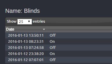

*update: in the logs the status of the blinds is always shown On/Off so not sure that this is the reason.
Thanks for the tip, I will post update tomorrow after the test.
- blinds_stat.JPG (19.92 KiB) Viewed 1585 times
Well.... I have this just set up for testing purposes (don't actually have blinds or whatsoever)
and it seems to work quite well
It works!!
Yesterday it still didn't, at least the blinds part. The lights were switched on.
Conclusion: checking the state of the blinds uses Open/closed, in the Set part I needed to use On/Off.
So, this morning it was all working.
great!
but why didn't it work at first yesterday?
Well, the first time because I used On/OFF for both the IF and THEN block.
Second day because I used Open/Close for both.
In the end it had to be Open/Close when checking the state and On/Off for setting the state.
Now all is good (tested the 930 shift today).
Thank you for your help.
