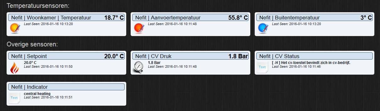

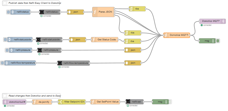

Re: Nefit Easy™
Post by pepijn »
I'm working on some documentation but here is my current flow (you need version 1.1.2 of https://www.npmjs.com/package/node-red- ... nefit-easy):
[{"id":"2070e95a.a9555a","type":"nefit-easy-config","z":"b83a61b3.47c5a","serialNumber":"","accessKey":"","password":"","timeout":"60"},{"id":"86f0c28c.790f4","type":"mqtt-broker","z":"","broker":"127.0.0.1","port":"1883","clientid":"","usetls":false,"verifyservercert":true,"compatmode":true,"keepalive":"60","cleansession":true,"willTopic":"","willQos":"0","willRetain":null,"willPayload":"","birthTopic":"","birthQos":"0","birthRetain":null,"birthPayload":""},{"id":"f0310caa.577e2","type":"inject","z":"b83a61b3.47c5a","name":"","topic":"nefit-status","payload":"","payloadType":"date","repeat":"30","crontab":"","once":true,"x":124,"y":75.35716247558594,"wires":[["c36e75f0.089e4"]]},{"id":"9fa51e6d.4853c","type":"debug","z":"b83a61b3.47c5a","name":"","active":true,"console":"true","complete":"true","x":1246.7540283203125,"y":248.60714721679688,"wires":[]},{"id":"e21d13d7.54d608","type":"mqtt in","z":"b83a61b3.47c5a","name":"domoticz/out/#","topic":"domoticz/out/#","broker":"86f0c28c.790f4","x":88.07138061523438,"y":617,"wires":[["be46893b.ec1a7"]]},{"id":"be46893b.ec1a7","type":"function","z":"b83a61b3.47c5a","name":"de-jsonify","func":"var payload = JSON.parse(msg.payload);\nreturn payload;","outputs":1,"noerr":0,"x":254.07138061523438,"y":617,"wires":[["82aa37b1.26f148"]]},{"id":"8f458b60.6c998","type":"debug","z":"b83a61b3.47c5a","name":"","active":false,"console":"false","complete":"true","x":965.3214111328125,"y":615.7500019073486,"wires":[]},{"id":"10471660.16b0ca","type":"function","z":"b83a61b3.47c5a","name":"Get SetPoint Value","func":"msg.payload = msg.svalue1\nreturn msg;","outputs":1,"noerr":0,"x":633.2658462524414,"y":616.0833168029785,"wires":[["de4fda49.b134f"]]},{"id":"82aa37b1.26f148","type":"switch","z":"b83a61b3.47c5a","name":"filter Setpoint IDX","property":"idx","rules":[{"t":"eq","v":"160"}],"checkall":"true","outputs":1,"x":432.51580810546875,"y":616.5555419921875,"wires":[["10471660.16b0ca"]]},{"id":"71ac80f8.677704","type":"comment","z":"b83a61b3.47c5a","name":"Read changes from Domoticz and send to Easy","info":"","x":189.07138061523438,"y":580,"wires":[]},{"id":"a47fff4f.db6778","type":"function","z":"b83a61b3.47c5a","name":"Domoticz MQTT","func":"// Configuration , set to -1 if you dont want to use the sensor\nvar IDX = {};\nIDX['nefit-setpoint'] = 160;\nIDX['nefit-roomtemp'] = 161;\nIDX['nefit-outdoortemp'] = 167;\nIDX['nefit-pressure'] = 162;\nIDX['nefit-boilerindicator'] = 168;\nIDX['nefit-statuscode'] = 163;\nIDX['nefit-flow-temperature'] =164;\n\n// Create message\nvar domoticz_msg = {};\ndomoticz_msg.topic = \"domoticz/in\";\ndomoticz_msg.payload = {};\n\nswitch (msg.topic) {\n    // Topics from nefit-status\n    case 'nefit-roomtemp'  :\n    case 'nefit-outdoortemp'  :\n    case 'nefit-boilerindicator':\n    case 'nefit-setpoint'  :\n    case 'nefit-statuscode' :\n        if (IDX[msg.topic] != -1) {\n            domoticz_msg.payload.idx = IDX[msg.topic];\n            domoticz_msg.payload.nvalue = 0;\n            domoticz_msg.payload.svalue = \"\" + msg.payload;\n            if (msg.topic == 'nefit-setpoint') {\n                domoticz_msg.payload.parse = false;\n            }\n        }\n\n        break;\n    case 'nefit-pressure'  :\n        if (IDX[msg.topic] != -1) {\n            var NefitJSON = JSON.parse(msg.payload);\n            domoticz_msg.payload.idx = IDX[msg.topic];\n            domoticz_msg.payload.nvalue = 0;\n            domoticz_msg.payload.svalue = \"\" + NefitJSON['pressure'];\n        }\n        break;\n    case 'nefit-flow-temperature' :\n        if (IDX[msg.topic])  {\n            var NefitJSON = JSON.parse(msg.payload);\n            domoticz_msg.payload.idx = IDX[msg.topic];\n            domoticz_msg.payload.nvalue = 0;\n            domoticz_msg.payload.svalue = \"\" + NefitJSON['temperature'];\n        }\n        break;\n    default:\n        return;\n}\n\nreturn domoticz_msg;\n","outputs":1,"noerr":0,"x":1063,"y":215.21429443359375,"wires":[["e232a850.baa2c","9fa51e6d.4853c"]]},{"id":"e232a850.baa2c","type":"mqtt out","z":"b83a61b3.47c5a","name":"Domoticz MQTT","topic":"","qos":"","retain":"","broker":"86f0c28c.790f4","x":1278.7499618530273,"y":130.96430206298828,"wires":[]},{"id":"2b74b537.2f9dc6","type":"inject","z":"b83a61b3.47c5a","name":"","topic":"nefit-pressure","payload":"","payloadType":"date","repeat":"300","crontab":"","once":false,"x":125,"y":305.357177734375,"wires":[["6d1aa742.8cfab8"]]},{"id":"e182c879.f16fd8","type":"comment","z":"b83a61b3.47c5a","name":"Publish data from Nefit Easy Client to Domoticz","info":"","x":187.07138061523438,"y":22,"wires":[]},{"id":"f506871a.acbe7","type":"rbe","z":"b83a61b3.47c5a","name":"","func":"rbe","gap":"","x":826.0714111328125,"y":56,"wires":[["a47fff4f.db6778"]]},{"id":"6ee39037.bb5c4c","type":"function","z":"b83a61b3.47c5a","name":"Parse JSON","func":"var NefitJSON = JSON.parse(msg.payload);\nmsg1 = {};\nmsg2 = {};\nmsg3 = {};\nmsg4 = {};\nmsg1.topic = 'nefit-setpoint';\nmsg1.payload = NefitJSON['temp setpoint'];\nmsg2.topic = 'nefit-roomtemp';\nmsg2.payload = NefitJSON['in house temp'];\nmsg3.topic = 'nefit-outdoortemp';\nmsg3.payload = NefitJSON['outdoor temp'];\nmsg4.topic = 'nefit-boilerindicator';\nmsg4.payload = NefitJSON['boiler indicator'];\nreturn [msg1,msg2,msg3,msg4];","outputs":"4","noerr":0,"x":622.5714111328125,"y":75.00001525878906,"wires":[["f506871a.acbe7"],["a47fff4f.db6778"],["a47fff4f.db6778"],["d369a91.8270318"]]},{"id":"fb1d1576.db6fb","type":"inject","z":"b83a61b3.47c5a","name":"","topic":"nefit-statuscode","payload":"","payloadType":"date","repeat":"60","crontab":"","once":false,"x":121.142822265625,"y":241.10716247558594,"wires":[["a4070a6c.adf5c"]]},{"id":"b169b9e6.8e827","type":"rbe","z":"b83a61b3.47c5a","name":"","func":"rbe","gap":"","x":798.142822265625,"y":251.57144165039062,"wires":[["a47fff4f.db6778"]]},{"id":"c36e75f0.089e4","type":"nefit-easy","z":"b83a61b3.47c5a","easyconfig":"2070e95a.a9555a","name":"","topic":"nefit-status","command":"status","x":300.5,"y":75.35716247558594,"wires":[["85ad8d13.d10d2"]]},{"id":"a4070a6c.adf5c","type":"nefit-easy","z":"b83a61b3.47c5a","easyconfig":"2070e95a.a9555a","name":"","topic":"nefit-statuscode","command":"display-code","x":296.5,"y":241.85716247558594,"wires":[["7e8c3906.0149c8"]]},{"id":"6d1aa742.8cfab8","type":"nefit-easy","z":"b83a61b3.47c5a","easyconfig":"2070e95a.a9555a","name":"","topic":"nefit-pressure","command":"pressure","x":297.5,"y":305.357177734375,"wires":[["147e4cc.4f491b3"]]},{"id":"de4fda49.b134f","type":"nefit-easy","z":"b83a61b3.47c5a","easyconfig":"2070e95a.a9555a","name":"","topic":"nefit-set","command":"set-temperature","x":810.0714111328125,"y":616.0000019073486,"wires":[["8f458b60.6c998"]]},{"id":"7e8c3906.0149c8","type":"json","z":"b83a61b3.47c5a","name":"","x":467.5,"y":241.85716247558594,"wires":[["389ea7b4.e23c38"]]},{"id":"85ad8d13.d10d2","type":"json","z":"b83a61b3.47c5a","name":"","x":455,"y":75.35716247558594,"wires":[["6ee39037.bb5c4c"]]},{"id":"d369a91.8270318","type":"rbe","z":"b83a61b3.47c5a","name":"","func":"rbe","gap":"","x":799.0714111328125,"y":201,"wires":[["a47fff4f.db6778"]]},{"id":"efab4bc5.94d228","type":"inject","z":"b83a61b3.47c5a","name":"","topic":"nefit-flow-temperature","payload":"","payloadType":"date","repeat":"300","crontab":"","once":false,"x":122,"y":382.00001525878906,"wires":[["2cb0fac.7081c06"]]},{"id":"2cb0fac.7081c06","type":"nefit-easy","z":"b83a61b3.47c5a","easyconfig":"2070e95a.a9555a","name":"","topic":"nefit-flow-temperature","command":"flow-temperature","x":443,"y":383.00001525878906,"wires":[["f797913b.e0a45"]]},{"id":"f797913b.e0a45","type":"json","z":"b83a61b3.47c5a","name":"","x":799,"y":382.00001525878906,"wires":[["a47fff4f.db6778"]]},{"id":"389ea7b4.e23c38","type":"function","z":"b83a61b3.47c5a","name":"Get Status Code","func":"var NefitJSON = JSON.parse(msg.payload);\nmsg.topic = 'nefit-statuscode';\nmsg.payload = \"\"+\"[ \"+NefitJSON['code']+\" ] \"+NefitJSON['description'];\nreturn msg;","outputs":1,"noerr":0,"x":630,"y":241.35714721679688,"wires":[["b169b9e6.8e827"]]},{"id":"147e4cc.4f491b3","type":"json","z":"b83a61b3.47c5a","name":"","x":799,"y":304,"wires":[["a47fff4f.db6778"]]}]
This will be the result in Domoticz:

dorenberg wrote:When back home, I am going to update. I will delete the statuscode part because my CV doesn't support it.
No, it's set in Domoticz MQTT. So the message towards Domoticz.
When you set your temperature on the Easy (manual, by app or by clock) the update comes in trough the regular nefit-status message. In your current situation (when not using parse=false) Node-RED tells Domoticz to update the SetPoint temperature. Domoticz changes the temp and sends a MQTT message to update the temperature. This message is picked up by the other flow which sets the new value on the Easy.
To illustratie:
Temp -15 --> Clock sets to 20 --> Message to Domoticz --> Domoticz set to 20 --> Message to Easy --> Manual set to 20.
So that seems a loop :)
By using parse=false it will look like this
Temp -15 --> Clock sets to 20 --> Message to Domoticz --> Domoticz set to 20 --> Parse =false so STOP
You can also set the nefit-statuscode timer to never.
