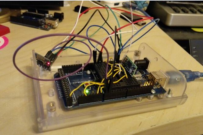

Since last Update We can add :
RFLink Gateway with Lan Interface !!
I found a way to use it on Wifi by adding ESP8266 to RFLink using Ser2net.
Just load this sketch to your ESP8266 : https://github.com/dparnell/esp8266-ser2net, of course adjust config to your home config
Plug ESP RX to Mega RX0 ESP tx to Mega TX1, ESP Enable and VCC to 3.3v Mega pin, ESP8266 GND to Mega Gnd, and ESP reset To Mega reset PIN.
On Domoticz, create a RFLink Gateway with Lan Interface, put your ser2net server ip and port then Rock n Roll !
And it works very good, like when on USB Plug.
Restictions :
- Only One client can connect to ser2net Server (if someone can made this sketch start 2 server or more to connect 2 or more client, please share, i need this).
- When ESP is plug to Mega, USB can only recieve but not send (this will not be to hard to allow both working on same time).

deennoo wrote:Since last Update We can add :
A few questions/comments:
The ESP8266 is not 5V safe on the GPIO pins (including TX/RX) and you should really use a levelshifter
ITYM that RX0 on Arduino should go to TX on ESP, and not RX
Why do you connect reset on the ESP to the Arduino reset? Why not leave it high or floating?
- Jan
Beaglebone Black, Raspberry Pi (A and B)
Multiple ESP8266 (DIY - temperature, humidity, light, door sensors)
USR-HTW (MQTT), HA7net, 2x Kankun wifi plug (MQTT)
WH1090 weatherstation + weewx (MQTT)
Hikvision IP cameras
KD101 fire alarms
RFXTRX433e + RFlink
deennoo
Posts: 784
Location: Bordeaux France
Re: Wifi RFLink
Post by deennoo »
Your right for Rx and Tx (on my first esp they was inverted).
Actually i never kill an esp with 5v on ESp RX and TX (i load frimewire from an arduino) , will think about it.
Reste : this is a way for me to reste both.
Feel free to give a full safe how to, if you want.
http://domo-attitude.fr

I have a ESP8266 and want to conntect it to my rflink.
But I have some issues.
What I did so far....
installed the espeasy software on the esp8266
but how should i configure it?
at the moment I did:
device: serial server
tcp port 23
Baud Rate: 57600
Data bits: 8
Parity: no parity
Stop bits: 1
next question how should connect this to my rflink
power is ok because I can connect to the configure webpage when I go to esp8266 ip adres
for rx and tx and did esp rx to mega tx0 and esp tx to meta rx0
in the topic start it says something else but this is how the picture is connected.
When I try to connect with domoticz it connects but after 30 sec it says no response.
domoticz version V2.3682
rflink version R35
ESP version 48
two more questions; Do i have to change something in the hardware options SDA and SDL
Protocol is on domoticz http is this ok?
thx
