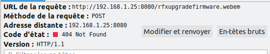

Do you see anything in the log, or the browsers debug console ?

Cissou
- Posts: 7
- Joined: Friday 02 January 2015 18:19
- Location: France
Re: [Beta] Updating RFX433E firmware
So there is nothing in the log file, but i see a 404 error in the debug console of the web browser for what I think to be the firmware upgrader

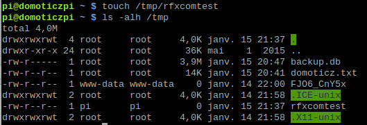

as the user running domoticz can you create a file in /tmp?
try:
try:
touch /tmp/rfxcomtest
ls -alh /tmpDebian Jessie: CuBox-i4 (Primary) w/Static Routed IP and x509 / BeagleBone with OpenSprinkler / BeagleBone Planted Aquarium / 3x Raspbery Pi2b GPIO Slaves
Yes I can
