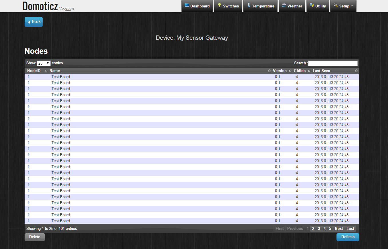

to day i have seen that the test board node has filled the mysensor gateway node list with 5 pages of nodes that all are identical. they are updated on the same time.
see my attached picture.
test board node entrys
test board.png (191.36 KiB) Viewed 1276 times

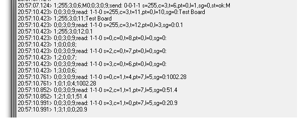

her is a log from my ethernet gateway:
Log from gateway
Log from gateway
does some one have an ideer what is going on?

mhko
Posts: 13
Joined: Wednesday 13 January 2016 20:37
Re: Strange behaviour.
Post by mhko »
Hi again.
I am still struggeling geting this to work.
can any body help me with this log?

date gateway recives data for the sensor, i can see that in the serial monitor and in MYScontroller, but the data does not registrat in Domoticz.
Today i hade 18 pages of unknown devices in my device list.
