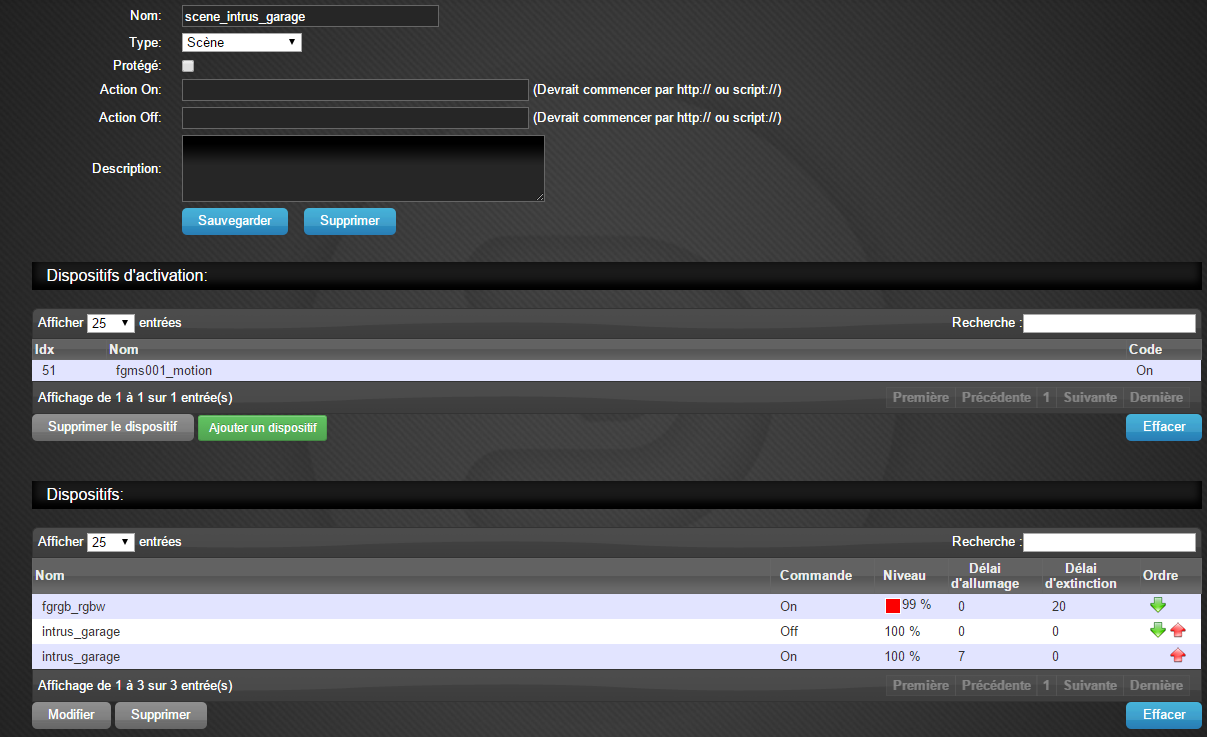

Then I have news ...
With .lui but I can not do it by creating a scenario, I can access the sound file from my camera and play.
I pass your hand over the motion detector
the fact scenario LED strip light a red and 7 seconds after the sound of my camera resounded.
Here's the scenario:
scenario intrus garage.png (310.67 KiB) Viewed 2152 times
I put the first red LED strip light for 20secondes, then Requette "Off" for the camera to start from zero and finally the Requette "On" for the sound that starts 7 seconds after the outbreak of the detector.
I am looking for help to create this szene .lua script but I do not know if I can choose the color of the LED strip
Merci de votre aide.
