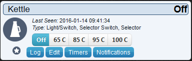

Sure, here's the code I'm currently using. It's split into two files (one lua and one python); the lua file for handling the selector switch in Domoticz and that calls the python script to connect to the Kettle.
As I've already mentioned this is the first python script I've ever written and I'm pretty new to lua too - so if anyone can improve them, I'm happy to receive a better version! :D
script_device_kettle.lua (domoticz/scripts/lua/script_device_kettle.lua)
  • You'll need to edit the script variable to the location of the python script on your system
  • My virtual device is called 'Kettle' - if yours is not, you'll need to change that
  • Based on a selector switch with buttons saying.. Off | 65 C | 80 C | 95 C | 100 C
  • I've included the code for a 'Warm' button, but haven't used or tested it

I've also coded into the lua script a 'turn-off' the (virtual) kettle after 300 seconds. This is so the device is switched off in Domoticz after it's finished boiling as these scripts don't do any checking to see if it's actually boiled.

Thanks for including the script. It works great! Your scripting skills are way better than mine.. :D Initialy had some trouble to trigger the LUA script until I noticed the "space" between the degrees and the "C". After also putting this into the selector button it triggers perfectly! Now just need to find the nice icon you have in your button... :D

The icon is one I made myself, well.. edited from another icon into this one, but you can find the zip attached, ready to add to the custom icons bit.

Waited until this weekend to install everything in the selector way, works like a charm. Now I only have to figure out a way in which 'on' functions as well since it isn't supported by my default app, Pilot on iOS.
