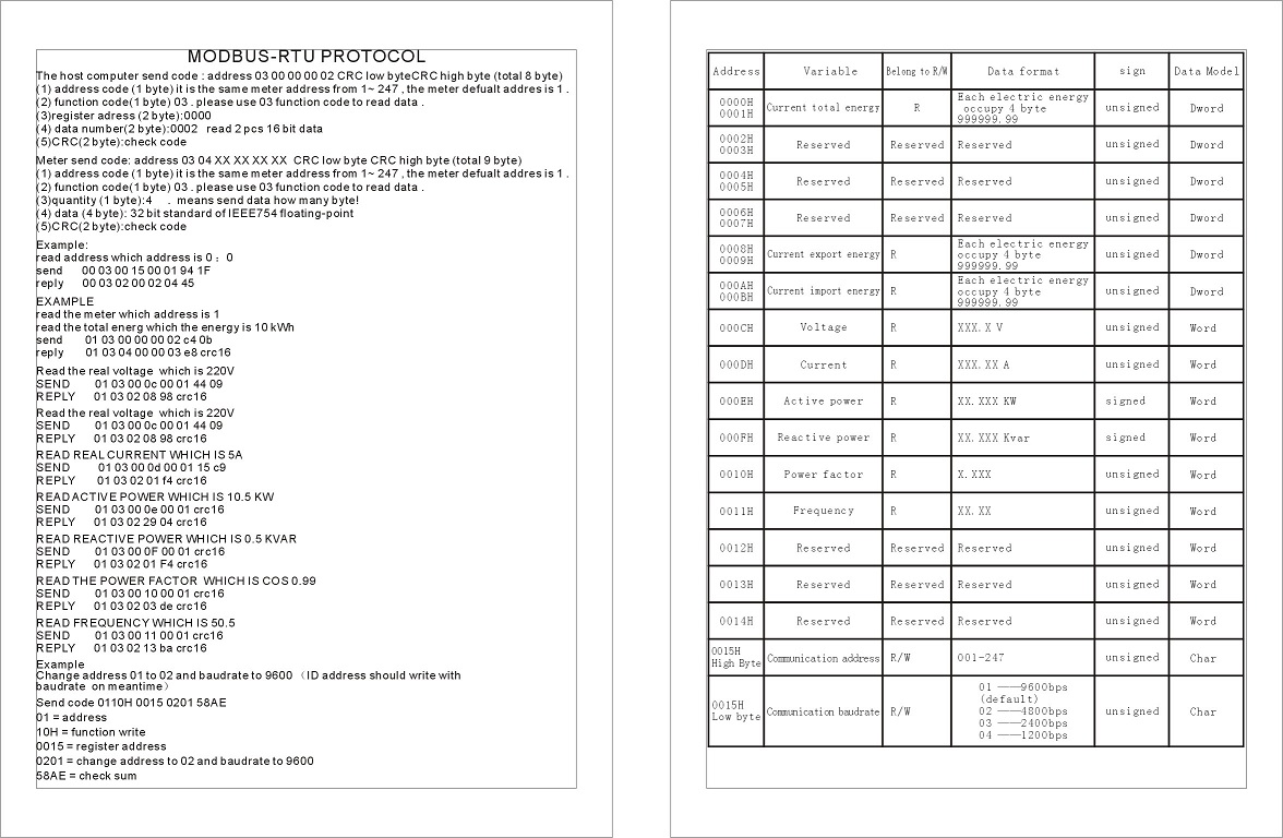

From friendly helpers received documentation & information related to another RS485-interface-implementation for the kWh-meter type DDS238-1ZN.
The communication settings and the message structure are rather transparantly described [although the quality of manufacturer's text requires 'some' rereading & guessing ....].
Each message applying the modbus-protocol has a header, a number of data-bytes and ends with a CRC applying 2 bytes.
The periodic command messages have a fixed layout, and therefore also a fixed CRC. Fortunately, the documentation showed the CRCs for the most essential command messages [for Lifetime Energy, Voltage, Current and Power]. For the other command messages an internet-online calcutor provided the CRC-values.

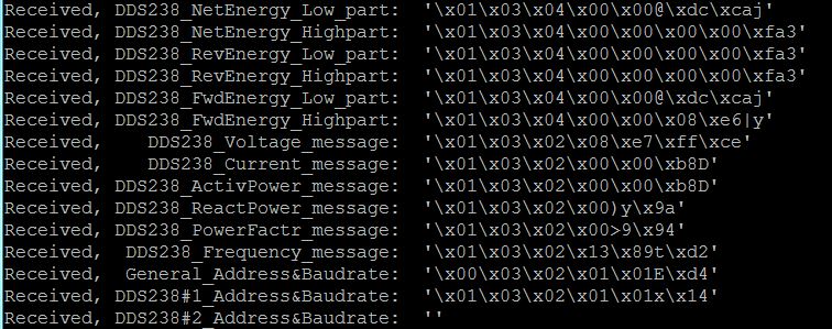

Using that information I tweaked the Python-test-script from Linksprite for a first, basic, straightforward implementation:
- Apply the serial or pyserial module of Python [additional modules pymodbus and minimalmodbus also exist for Python, but their application is not (yet) clear to me]
- For the command messages mentioned above, all contents are known, and I have made a series of messages with fixed strings to be transmitted.
- Handshaking is the rule, therefore after transmission of each command/request message wait for response.
The response consists of a message with following layout (for default configuration of DDS238-1ZN):
- Slave-address 1 byte, fixed 01(hex)
- Function-code 1 byte, fixed 03(hex)
- Payload-size 1 byte, variable 02(hex) or 04(hex)
- Payload of 2 or 4 Data-bytes, with hex-contents
- CRC, 2 bytes, with hex-contents
The readout-lines in the Python-script are similar to the first one shown below (followed by comparable lines for the other messages covering all other 'user'-registers):
print "Received, DDS238_NetEnergy_Low_part: ", repr(usart.read(10)) In the screenshot you can see that all request-messages to the occupied Slave-address 01 get a meaningful response, but some responses are distorted & incomplete [because a complete response should be either 9 or 7 bytes].
The bottom Python-script-line calling the communication-settings from Slave-address 02 correctly reports a 'no response', shown as a 'blank'
Manually converting the received strings of hex-numbers I see realistic decimal values.
Obviously the conversion should be automated within the Python-script, and followed by application of the data.
Therefore the next step is extension of the script with timed read-out, upload to Domoticz (and PVOutput), etc.

The distorted responses and the challenge for decoding triggered me to install the Python-module minimalmodbus.
With this installation & application a lot of the 'problems' described in my previous 2 messages seem to have been solved:
- sending requests is much easier incl. embedded automatic calculation and inclusion of CRC
- reception of messages is now without any problems [distorted responses apparently still can be decoded through minimalmodbus]
- automatic conversion of the payload-bytes to value(s).
The short request message instrument.read-register(x,y) nicely produces for register-address x an output value from the 2 payload-bytes.
By setting y in that message, the message-call outputs the value of registeraddress x as real/float value with y decimals: y=0 effectively results in output as integer value.
The output for the long request message instrument.read_registers(x,y) for register-address x and for y registers is for y=2 not a single integer value from the 4 payload-bytes, but 2 integer values in a list. Requires an extra script-line to extract the integer values from this list and then combination & multiplication with a float-factor produces the 'real' value.
The result of the script is shown in the screenshots in the attachments.
This step of development accomplished!
- information can be read from the kWh-meter,
- data can be extracted from the response-messages and converted to real/float values.

- Script-output
- Knipsel151216Scriptoutput.JPG (64.65 KiB) Viewed 16651 times
- Settings-report
- Knipsel151216Settings.JPG (30.36 KiB) Viewed 16658 times

To get the RS485-interface running with my Python-script means that I had to 'manually' install the Python-modules serial, minimalmodbus and ephem
Realisation of installation for each module:
- download the related tar-package to PC
- unzip the package
- by means of WinScp transfer the resulting folder to the Raspberry to a selected directory
- at the commandline of Putty change the path to that same directory in the Raspberry
- run the Python setup-function for the package, which installs the package
After that installation a Python-script can locally import the module.
