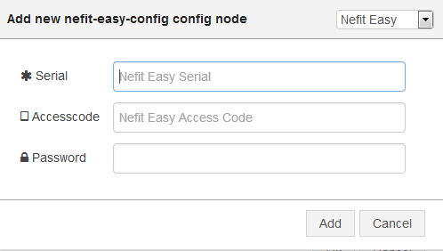

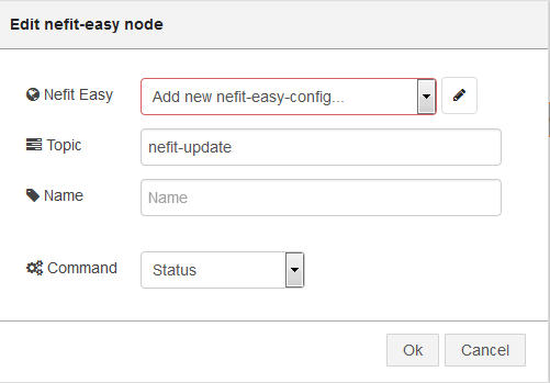

pepijn wrote:All,
As mentioned before using the scripts is not the way to go.
Right now I'am working on a (native) Node-RED node for Nefit Easy.
The attachment Nefit Node.png is no longer available
As you can see I'am able to communicate to the Easy directly (so without scripts). But the node is not finished yet.

I published the first version of the Node to github.
You can install it using:
sudo npm install pepijng/node-red-contrib-nefit-easy -g
When installed a new node will be installed in Node-RED
From now on you can configure your own flows, don't forget to configure it :)
Sample flow:
[{"id":"ff25878b.28a9f8","type":"mqtt-broker","broker":"127.0.0.1","port":"1883","clientid":"","usetls":false,"verifyservercert":true,"compatmode":true,"keepalive":15,"cleansession":true,"willQos":"0","birthQos":"0"},{"id":"f3fdab6a.9716d","type":"inject","z":"d60d4263.22172","name":"","topic":"nefit-update","payload":"","payloadType":"date","repeat":"30","crontab":"","once":true,"x":141,"y":148.00000190734863,"wires":[["344cad2f.e89e4a"]]},{"id":"c2dbd85e.feb6","type":"debug","z":"d60d4263.22172","name":"","active":true,"console":"true","complete":"true","x":1255.2539672851562,"y":274.74998664855957,"wires":[]},{"id":"f468c591.d5b0a8","type":"mqtt in","z":"d60d4263.22172","name":"domoticz/out/#","topic":"domoticz/out/#","broker":"ff25878b.28a9f8","x":202.99996948242188,"y":445,"wires":[["4f50f277.195ef4"]]},{"id":"4f50f277.195ef4","type":"function","z":"d60d4263.22172","name":"de-jsonify","func":"var payload = JSON.parse(msg.payload);\nreturn payload;","outputs":1,"noerr":0,"x":368.9999694824219,"y":445,"wires":[["91c9a815.09fae"]]},{"id":"7dec00a4.5473f","type":"debug","z":"d60d4263.22172","name":"","active":true,"console":"false","complete":"true","x":1080.25,"y":438.74998664855957,"wires":[]},{"id":"36479ab6.9ba30e","type":"function","z":"d60d4263.22172","name":"Get SetPoint Value","func":"msg.payload = msg.svalue1\nreturn msg;","outputs":1,"noerr":0,"x":748.1944351196289,"y":444.0833168029785,"wires":[["f6959acc.46eb18"]]},{"id":"91c9a815.09fae","type":"switch","z":"d60d4263.22172","name":"filter Setpoint IDX","property":"idx","rules":[{"t":"eq","v":"160"}],"checkall":"true","outputs":1,"x":547.4443969726562,"y":444.5555419921875,"wires":[["36479ab6.9ba30e"]]},{"id":"736e147f.478be4","type":"comment","z":"d60d4263.22172","name":"Read changes from Domoticz and send to Easy","info":"","x":303.9999694824219,"y":408,"wires":[]},{"id":"86d83761.b74138","type":"function","z":"d60d4263.22172","name":"Domoticz MQTT","func":"// Configuration\nconst IDX_SetPoint = 160;\nconst IDX_RoomTemp = 161;\nconst IDX_Pressure = 162;\nconst IDX_StatusCode = 163;\n\n\nvar domoticz_msg = {};\ndomoticz_msg.topic = \"domoticz/in\";\ndomoticz_msg.payload = {};\n\nif (msg.topic == 'nefit-update')  {\n    var NefitJSON = JSON.parse(msg.payload);\n    domoticz_msg.payload.idx = IDX_RoomTemp;\n    domoticz_msg.payload.nvalue = 0;\n    domoticz_msg.payload.svalue = \"\" + NefitJSON['in house temp'];\n}\nif (msg.topic == 'nefit-pressure')  {\n    var NefitJSON = JSON.parse(msg.payload);\n    domoticz_msg.payload.idx = IDX_Pressure;\n    domoticz_msg.payload.nvalue = 0;\n    domoticz_msg.payload.svalue = \"\" + NefitJSON['pressure'];\n}\nif (msg.topic == 'nefit-setpoint')  {\n    domoticz_msg.payload.idx = IDX_SetPoint;\n    domoticz_msg.payload.nvalue = 0;\n    domoticz_msg.payload.svalue = \"\" + msg.payload;\n}\nif (msg.topic == 'nefit-statuscode')  {\n    domoticz_msg.payload.idx = IDX_StatusCode;\n    domoticz_msg.payload.nvalue = 0;\n    domoticz_msg.payload.svalue = \"\" + msg.payload;\n}\n\nreturn domoticz_msg;","outputs":1,"noerr":0,"x":1035.4999465942383,"y":214.35714721679688,"wires":[["78e7ad56.9981fc","c2dbd85e.feb6"]]},{"id":"78e7ad56.9981fc","type":"mqtt out","z":"d60d4263.22172","name":"Domoticz MQTT","topic":"","qos":"","retain":"","broker":"ff25878b.28a9f8","x":1280.2499618530273,"y":216.10714149475098,"wires":[]},{"id":"86f7256b.4702","type":"inject","z":"d60d4263.22172","name":"","topic":"nefit-pressure","payload":"","payloadType":"date","repeat":"300","crontab":"","once":false,"x":154.75,"y":316.7500171661377,"wires":[["e00efb82.b052e8"]]},{"id":"89bae4a3.1d509","type":"comment","z":"d60d4263.22172","name":"Publish data from Nefit Easy Client to Domoticz","info":"","x":296.9999694824219,"y":98,"wires":[]},{"id":"538a564.a08a428","type":"rbe","z":"d60d4263.22172","name":"","func":"rbe","gap":"","x":801.2142639160156,"y":113.99999809265137,"wires":[["86d83761.b74138"]]},{"id":"ffed6cb1.d18d58","type":"function","z":"d60d4263.22172","name":"Get Setpoint","func":"var NefitJSON = JSON.parse(msg.payload);\nmsg.topic = 'nefit-setpoint';\nmsg.payload = NefitJSON['temp setpoint'];\nreturn msg;","outputs":1,"noerr":0,"x":668.0714111328125,"y":130.14285469055176,"wires":[["538a564.a08a428"]]},{"id":"40f53ce3.b10fbc","type":"inject","z":"d60d4263.22172","name":"","topic":"nefit-statuscode","payload":"","payloadType":"date","repeat":"10","crontab":"","once":false,"x":114.642822265625,"y":230.25000190734863,"wires":[["d9c31f75.e6cf1"]]},{"id":"58e78dae.bc17b4","type":"function","z":"d60d4263.22172","name":"Get Status Code","func":"var NefitJSON = JSON.parse(msg.payload);\nmsg.topic = 'nefit-statuscode';\nmsg.payload = \"\"+\"[ \"+NefitJSON['code']+\" ] \"+NefitJSON['description'];\nreturn msg;","outputs":1,"noerr":0,"x":623.5,"y":220.50000190734863,"wires":[["fde852ee.6a0248"]]},{"id":"fde852ee.6a0248","type":"rbe","z":"d60d4263.22172","name":"","func":"rbe","gap":"","x":802.642822265625,"y":231.71428108215332,"wires":[["86d83761.b74138"]]},{"id":"344cad2f.e89e4a","type":"nefit-easy","z":"d60d4263.22172","easy":"","name":"","topic":"nefit-update","command":"status","x":279.0714111328125,"y":147.5714282989502,"wires":[["d543561c.93741","138477f1.3e55a8"]]},{"id":"d9c31f75.e6cf1","type":"nefit-easy","z":"d60d4263.22172","easy":"","name":"","topic":"nefit-statuscode","command":"display-code","x":298.0714111328125,"y":260.5714282989502,"wires":[["e460913f.e3e5f8"]]},{"id":"e00efb82.b052e8","type":"nefit-easy","z":"d60d4263.22172","easy":"","name":"","topic":"nefit-pressure","command":"pressure","x":358.0714111328125,"y":325.5714282989502,"wires":[["1e345af1.a80ca5"]]},{"id":"f6959acc.46eb18","type":"nefit-easy","z":"d60d4263.22172","easy":"","name":"","topic":"nefit-set","command":"set-temperature","x":938.0714111328125,"y":436.5714282989502,"wires":[["7dec00a4.5473f"]]},{"id":"e460913f.e3e5f8","type":"json","z":"d60d4263.22172","name":"","x":459.0714111328125,"y":217.5714282989502,"wires":[["58e78dae.bc17b4"]]},{"id":"d543561c.93741","type":"json","z":"d60d4263.22172","name":"","x":534.0714111328125,"y":125.5714282989502,"wires":[["ffed6cb1.d18d58"]]},{"id":"138477f1.3e55a8","type":"json","z":"d60d4263.22172","name":"","x":453.0714111328125,"y":175.5714282989502,"wires":[["86d83761.b74138"]]},{"id":"1e345af1.a80ca5","type":"json","z":"d60d4263.22172","name":"","x":580.0714111328125,"y":305.5714282989502,"wires":[["86d83761.b74138"]]}]
You don't need any of the scripts mentioned earlier in this post! This is a native Node-RED node

i know it still not finished but i missing get and put commands in node.
For example i want to read /heatingCircuits/hc1/actualSupplyTemperature
its not possible to do up to now from node-red interface
