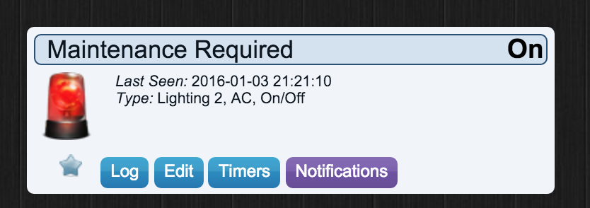

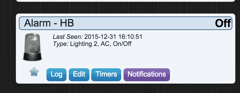

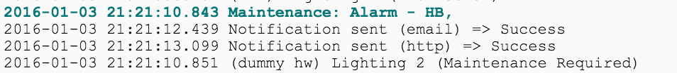

Re: Set a switch ON that is already ON & update last seen ti
I have something "basic" - its not running in cron yet - but theres no reason it will have an issue - but I have checked with some friends who are running Domoticz on a PI - and the python install there doesn't have one of the libraries I use, nor does it have the python installers (pip or easy_install) - I think either or both of them should install no problem - python is very popular on the pi - but I don't want to start recommending installation of things that might cause issues - I will share the script as it is now if anyone is interested - but - not tested on a PI or a windows box - i know that the requests library isn't there (pi) and will need to be installed (hence wanting pip or easy_install)
The script as I have written it does this - everytime it runs it gets from Domoticz all the devices, then goes through them looking for devices where the name ends in HB (for heartbeat) - for each of those devices it checks the last updated time - works out the difference between that and "now" and rounds the answer to the nearest hour. If the difference in time is more than 6 hours (easily changed in the script) - then the script notes its name.
When all the devices have been checked - if any have been noted as being "dead", it does the following - logs a message in the domoticz log saying maintenance required for the device(s) and it turns on a virtual sensor I have created called "Maintenance Required" (name isn't important - you just need the IDX of it from the devices screen) - that switch has a notification on it when its turned on - that sends email/push notification.
I was hoping that this virtual sensor wouldn't update if I set it "on" when it was already "on" - but THAT switch does run the "on" actions (which is ironic since that is why we are doing all this for the real sensors !!!!!) - so I might modify the script to check if the "Maintenance Required" switch is on before setting it again........ I don't like being nagged about things that need to be fixed - I have people in my life who do that for me!
This way you get a visual indication on the UI for maintenance and an entry in the log telling you what's "broken"
The actual sensor The "Maintenance Required" device The entry in the log Going to tweak it a little bit more - and as I say - happy to share with the caveats of only tested on my setup, it needs the requests library - and in my case I have modified mysensors to always update my heartbeat sensors - not tried it with distance or any other kind of sensor - but it works on device name and last update time (the date format is the one I get on my system - don't know if all locales will return the same format but I can probably work out what it should be if its different for other locales.
Any interest? - let me know - and i will start another thread in the scripts section.
