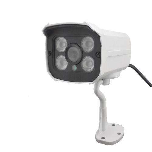

EDIT: cam is HI3516C
See image, onvif compatible, 1080P, 3 streams.
Viewable through the danale app on android.....
In a browser I can view the cam, and also vlc is displaying perfectly. Even in synology surveillance station he is working good.
But not in Domoticz.
Hope anyone can help.
- cam.JPG (12.39 KiB) Viewed 40881 times

So in other words your cam must have snapshot function.
My ANRAN ipcam is not supporting JPG snapshots. But there is an undocumented way..
Try:Code: Select all
http://IP_TO_CAM/webcapture.jpg?command=snap&channel=1
