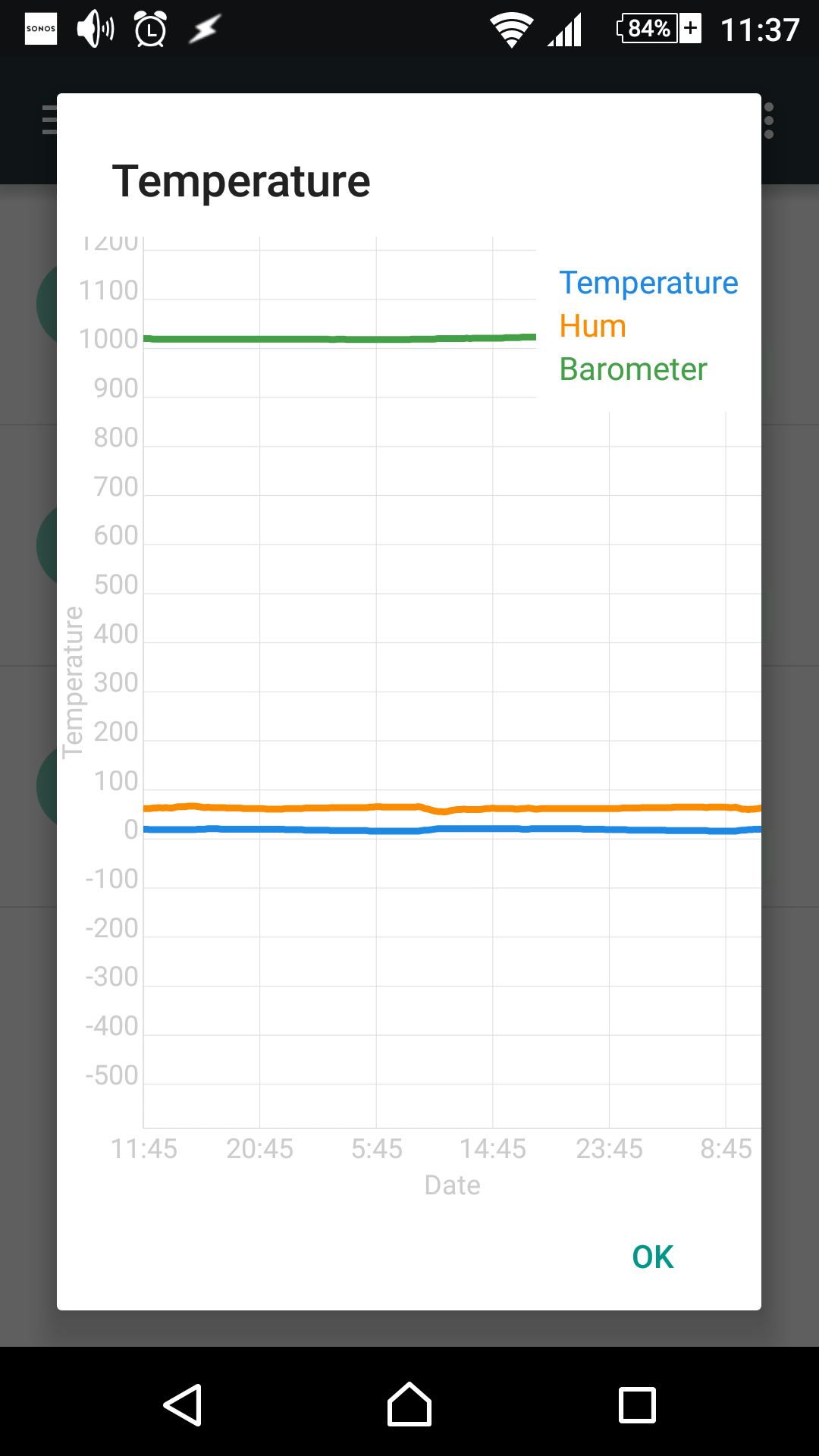

Here is the graph with the temperature and barometer as you can see, you can not see the fluctuations very well.Jango wrote:Hello developers,
Is it possible to generate separate graphs for temperature, humidity and barometer?
The ranges off the graphs are also very wide. If they are smaller you can see the fluctuations better.
Verstuurd vanaf mijn E6853 met Tapatalk
