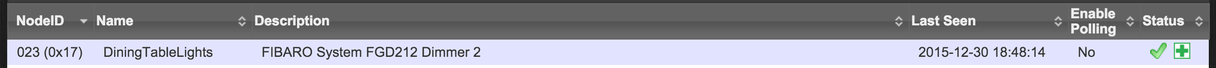

Just installed the FGD212 device. With a push switch the dimmer is working perfectly and I can enable/disable/dimm the lights. Openzwave detects the FGD212 perfectly. The problem is that I cannot enable/disable/dimm the lights from Domoticz. Any idea what the problem could be?
This is the error message I'm getting in the log window:
2015-12-30 18:44:24.034 Error: OpenZWave: Node not found! (NodeID: 4119, 0x1017)
2015-12-30 18:44:28.209 Error: OpenZWave: Node not found! (NodeID: 4119, 0x1017)
2015-12-30 18:44:29.123 Error: OpenZWave: Node not found! (NodeID: 4119, 0x1017)
Which is a bit strange as the node ID in the Openzwave window is 23 (0x17).

I'm using Domitcz Version 3.530 with OpenZWave USB Version: 1.3-523-gb258e9e on an Aeotec Z-Stick Gen5 USB stick.
