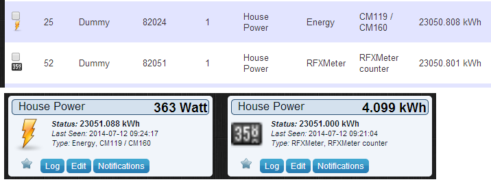

In Domoticz my devices looks like this, one shows current usage and one shows summary for the day:
The script is run from a cron job every 5 minutes and exits if another process is already running it. This auto starts it at boot time and also handles any restarts if required. The logging holds 10MB of log data in 10 files and rotates when they are full, that is controlled in the .conf file where you can also set the log level. Changing it from INFO to DEBUG will make it dump the XML to the log which is probably what you will need.
Runs under Python 2 on the same machine as Domoticz.
Credit where its due, I started from this script https://github.com/frankp/python-raven/ ... _script.py which publishes the data to MQTT.

@Dnpwwo
I tried to understand your code, not easy for me.
You have 2 devices, 1 called domDevice, the left one (CM119/CM160)in the capture and the second (RFXMeter) is domTotalDevice (at the right).
Both have the same kwh values, so why don't you keep the first one only ?
I see that you summarize something as the second parameter (kwh) for the s.value.
Do you directly get kwh from your appliance or only watt that you "transform" to get kwh ?

@JC38
The script posts 2 values to Domoticz, Instantaneous Demand & Summary (total Kwh). Initially I wasn't sure the best device type to map these to so I played around and ended up with two that seemed useful. You are correct that they are fundamentally same but the graphing options are different and one shows current usage while the other shows usage today. I don't actively use them for anything yet so left them both until I could see which long term charts were the most useful.
The summary code is a slight hack. My meter delivers summary data formatted to three decimal places but actually only reports to the 1/10 of a Kwh so the Domoticz summary updates were a bit infrequent. I made the code generate an interpolated value to smooth things out a bit. I think you can rip that bit out.
Would it be useful if I created a simplified version with all logic ripped out that just dumps out the XML?
