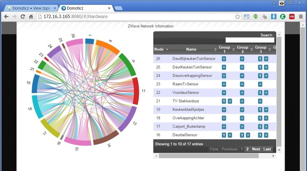

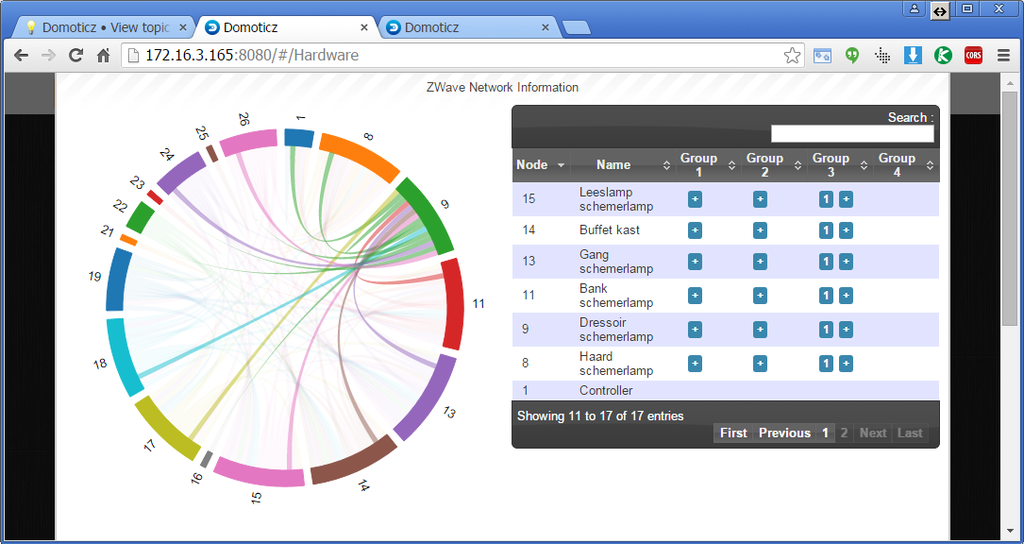

trekker25
- Posts: 40
- Joined: Tuesday 26 May 2015 10:50
Re: Scene switching causes faulty status of zwave switch
seems like a healthy network too me???
So i really have the idea that Domoticz is sending both an ON + OFF when only an ON is needed and both an OFF and ON when only a OFF is needed? Can i debug this somehow?
(or maybe remove all the scenes and add them again, but rather want to find out why it's going wrong!)
For example this is the light Dressoir and seems to have connection with all the lamps + controller and it this it's log from last days:

- gizmocuz
- Posts: 3086
- Location: Top of the world
Dont know if this helps, but the controller (node number 1), should be in all the nodes 'group 1'
in your switch manual, also check where the switch status is send to, maybe this is 'group 3' then you need to add the controller (number 1) in group 3
