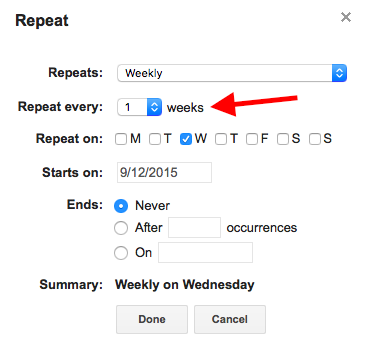

Why does it has to be so difficult? IMHO setting timers is one of the most basic functions you would expect from HomeAutomation software.
Sure you can program everything in Lua of PHP or integrate with other systems, but to me if you have to do that for this kind of "basic" functionality, that defies the added value of having an easy to set-up but even more to maintain home automation system. And I'm not even talking about the WAF ;)
We are just talking about adding the following options (see arrow), in the week and monthly setting to get it just as flexible as e.g. Google Calendar:
Also the option to set the event to End after x occurrences or at a day is really something that is missing in the current implementation of Domoticz. How great would it even be if this could be implemented for the timer-plan settings (in the general settings menu) scheduling as well!

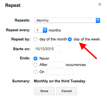

And adding the option to schedule items on the "x th" day of the month, or every "first sunday" of the month:
