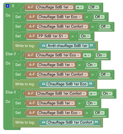

Here is what I did for mine and it works
Capture d’écran 2015-12-10 à 21.47.25.png (108.76 KiB) Viewed 1935 times
Modes are managed through lua script.
Where
"Chauffage sdb 1er" is your "Off" switch
"Chauffage seb Eco" is your "Eco" switch
"Chauffage seb Confort" is your "Confort" switch
Hope it'll help
JC

Hi elgarne
Yes there are on/off switches.
Blocky does the following:
When Heating switch is switched Off, Eco and Confort switches are switched Off -> Heating off
When Eco switch is switched On, Heating switch is switched On and Confort is switched Off -> Heating running in Eco mode
When Confort switch is switched On, Heating switch is switched On and Eco is switched Off -> -> Heating running in Confort mode
Yes I use it only for the bathroom (Additional heating). The rest of the house is controlled by an other heating system.
