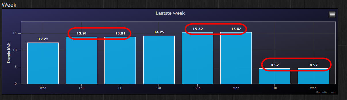

I am using an Omnik 3.0k-TL2.0 inverter for my 2500Wp PV system. The data is logged in Domoticz using "the script from Wouterrr".
Realtime data is captured perfect and matches the data from the inverters webpage and omnik portal.
The total energy however is not working OK, it happens more than regular that the same values are stored on different consecutive days but never more than 2.
Does anyone recognize this behaviour or can may be suggest an solution.
Omnik Inverter Daily Totalizer Energy Double Values

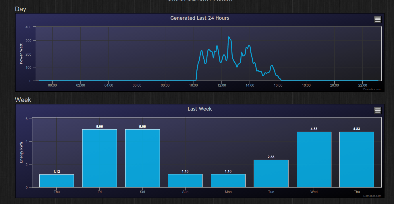

Re: Omnik Inverter Daily Totalizer Energy Double Values
I seem to have the same problem. See the attached image...
Also my Virtual sensor "Omnik Current / Return " displays 3 values: The current Power in W and the E-today value twice. I understood it should also show the lifetime total.
Sorry, I'm no (Python- or whatever) programmer. Is it possible to adjust the script to query the lifetime total energy from the inverter and update it's value in the virtual Sensor accordingly?
Or is not an updatable value and is it / should it be added up by Domoticz, therefore showing the accumulated energy total since registering it in Domoticz? Why doesn't it show either one?
Furthermore it seems that somehow this script leads to inaccurate results in conjunction with the LUA script from https://www.domoticz.com/wiki/Upload_en ... o_PVoutput that I use to upload the production values along with consumption values. The Energy production seems to get uploaded only after the power has reached about a 1000 W. Th energy production shown in PVoutput is about half of that monitored by the Omnik inverter (and displayed in the Omnik Portal) Now why is that?
thanks for any help...
