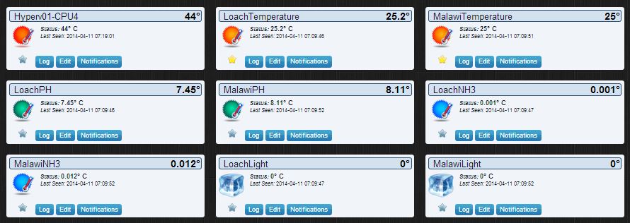

Here is a picture of my virtual sensors that are updated by the script
Derik
Posts: 1605
Re: Seneye Fish Tank Monitor
Post by Derik »
looking great..

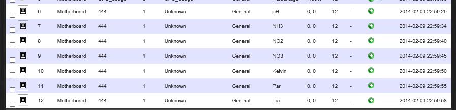

I use these:
http://www.seneye.com/devices/seneye-home
I have made some progress today making appropriate sensor types, right now I add them all as temperature and its not great, I have been modifying the code and have this so far, needs a little tidying and also adding to the UI:
