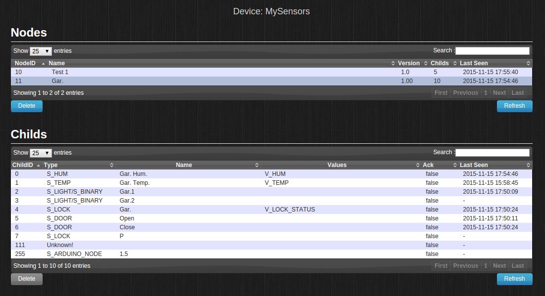

Already checked, this is the detail (setup) of sensor 11 on domoticz gui :
sensor setup
sensor setup
1) Sensors 2 and 3 receive message type 36. This is the received message on my node : 11;2;1;1;36;1\n
2) :shock: Looking at the picture, I just realize that sensor 5 and 6 are last seen today a few minutes ago when I used my garage door (so the notification is received) but the state is not reported on domoticz display.
3) I don't know what sensor 111 and 255 are. Any idea ?

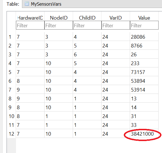

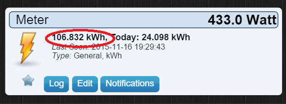

Another unrelated question - do you know which value I should change in the DB (domoticz.db) in order to change the total consumption value (MySensors - node 10 - child 1)
I have changed the value below, but it did not work.
