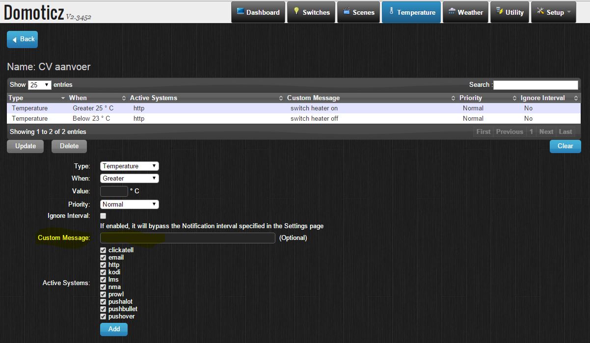

Hello Stuntteam,
OK, got the RF-link to work and all button presses from the two remotes are recorded and they are now nicely added in the Devices section.
Can I use a custom message to perform an action to switch ON/OFF with the socket?
Which code and where to place?
Am I on the rigth track?
If I make a .lua script for the switching which code do I have to use so the RF-link transmits them?
Will the
-- script to check a temperature and swicth on/off a 433 switch
if (devicechanged['CV aanvoer_Temperature']) then
temp = tonumber(devicechanged['CV aanvoer_Temperature'])
 if (temp >= 25.0) then
   commandArray['000FBE63,	0']='on'
   commandArray['CV aan/uit']='on'
   print ('vloerpomp aan')
 if (temp <= 23.0 ) then
   commandArray['000FBE63,	0']='off'
   commandArray['CV aan/uit']='off'
   print ('vloerpomp uit')
return commandArray
Your guidance would be appriciated as I could not google anywhere the info.
Paco

Stuntteam
Posts: 399
Joined: Wednesday 06 May 2015 16:39
Re: RFLink - USB Gateway - Introduction
Post by Stuntteam »
You might want to check:
http://www.domoticz.com/forum/viewtopic.php?f=15&t=7799
It seems it was initially not working in Blocky but that should have been fixed recently.
In Lua, I figure you need to change the "switch" as Domoticz knows it.
So if you have for example a KAKU switch added to Domoticz as "Heater 1".. then you would change the state of "Heater 1".
If you would send a command directly to rflink the state of "Heater 1" would probably not be updated.
To know how commands are send to rflink, simply change the state of one of your switches and check the logfile..
It will show the command that was send.
