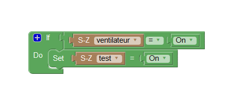

Hi Skunk
Try using
If Do.PNG (1.54 KiB) Viewed 1144 times
Instead of
If Do Else 1.PNG (1.93 KiB) Viewed 1144 times
Which I guess is waiting for an "else if" condition
If Do Else 2.PNG (7.41 KiB) Viewed 1144 times
JC
