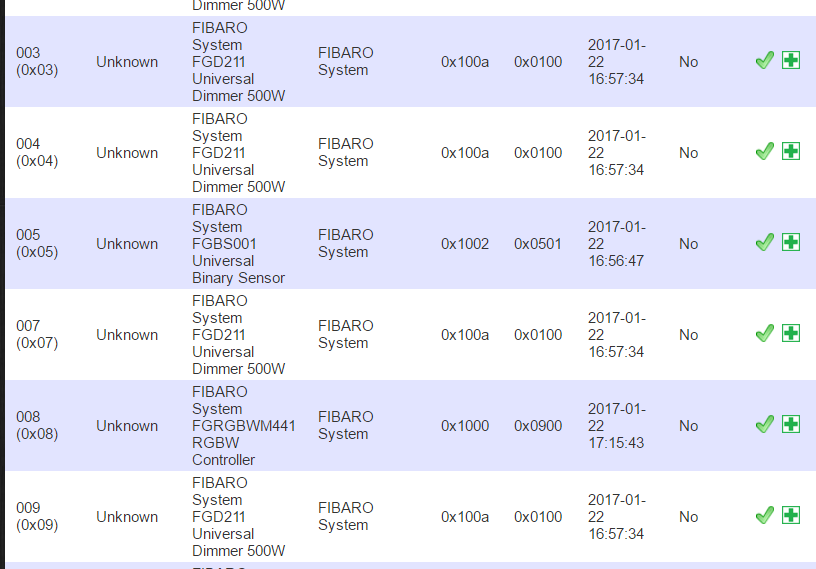

Did a "soft reset controller" today, after that takes a while for the nodes to reappear in the list. Nodes that were deleted from domoticz reappear as well.
But the Name attribute is set to unknown and the Enable polling set to NO
