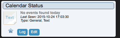

ok.. another problem with the calendarID. Sorry about that..
Now it seems to be working :-)
I'll do some more testing and get back with the results.
Thanks again for your time
2015-10-24 17:03:29.704 LUA: GCal3 V 1.0.1: Command /bin/ls /root/GCal3/GCal3.sem returned true
2015-10-24 17:03:29.705 LUA: GCal3 V 1.0.1: Device 24 claimed semaphore
2015-10-24 17:03:29.705 LUA: GCal3 V 1.0.1: StartMin is 2015-10-23T22:00:00Z StartMax is 2015-10-25T13:03:00Z
2015-10-24 17:03:29.705 LUA: GCal3 V 1.0.1: End of day is 2015-10-24T23:59:59
2015-10-24 17:03:29.705 LUA: GCal3 V 1.0.1: local function: requestCalendar
2015-10-24 17:03:29.705 LUA: GCal3 V 1.0.1: local function: get_access_token
2015-10-24 17:03:29.705 LUA: GCal3 V 1.0.1: Getting a new token
2015-10-24 17:03:30.090 LUA: GCal3 V 1.0.1: Got new token
2015-10-24 17:03:30.091 LUA: GCal3 V 1.0.1: Checking google calendar
2015-10-24 17:03:30.454 LUA: GCal3 V 1.0.1: No event in the next day. Retry later...
2015-10-24 17:03:30.454 LUA: GCal3 V 1.0.1: local function: setTrippedOff
2015-10-24 17:03:30.454 LUA: GCal3 V 1.0.1: Event-End Inactive
2015-10-24 17:03:30.508 LUA: GCal3 V 1.0.1: Device 24 released the semaphore - reason: calendar check complete
2015-10-24 17:03:30.509 LUA: GCal3 V 1.0.1: Next check will be in 10800 sec on 2015-10-24 at 20:03:30
2015-10-24 17:03:30.510 LUA: GCal3 V 1.0.1: Device 24 released the semaphore - reason: initialization complete
2015-10-24 17:03:30.510 LUA: GCal3 V 1.0.1: Switch recent status: Off
