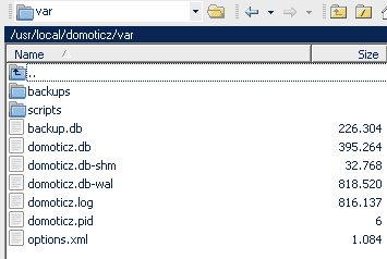

Here is the main folder structure on my synology, in case it helps you.
