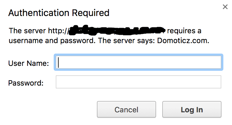

mrf68 wrote:Try surfing to https://yourhomeipaddress:port. Does it ask for credentials and do you see a lock in the url? In that case I think you have an https connection.
Yes it is asking for my login name/password. But it is still HTTP. See screenshot
HTTP screenshot
HTTP screenshot
Screen Shot 2015-10-21 at 10.03.31.png (40.24 KiB) Viewed 26257 times
mrf68
Re: native HTTPS / SSL support in Domoticz
Post by mrf68 »
HTTPS is normally on port 443. Domoticz also listens for https to port 443. I read you want to use another port. Have you told Domoticz to serve https to that other port? When you open the file /home/pi/domoticz/domoticz.sh you'll see:
DAEMON_ARGS="-daemon -www 8080 -sslwww 443"
When you want to use a different port for SSL, you need to change that line and change 443 to for example 8443. Restart Domoticz and surf to HTTPS://ipaddres:8443 and look again.
rgroothuis
Posts: 347
Post by rgroothuis »
mrf68 wrote:HTTPS is normally on port 443. Domoticz also listens for https to port 443. I read you want to use another port. Have you told Domoticz to serve https to that other port? When you open the file /home/pi/domoticz/domoticz.sh you'll see:
Thanks, I think this is the trick I was looking for. This issue is now solved (for me), I'm ussing now https and the login name/password to access Domoticz from the outside world.
